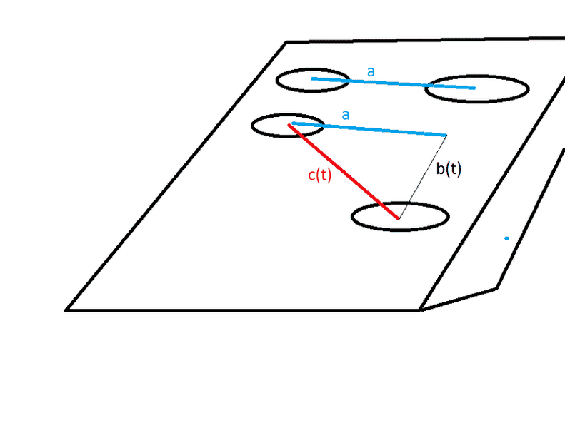

Two cyllinders of equal size and of mass M (one hollow, one solid) are connected along their common axis by a light rod and placed on an inclined plane with an incline of α (both cylinders are on the same height initially). The system of cylinders then begins to roll down the inclined plane without skidding. Find the tension in the rod.
Given variables: M, α, g (gravitational acceleration)[/B]
2. The attempt at a solution and the problems I'm facing
My biggest problem is imagining what causes the tension in the first place. My guess is, due to the cylinders having equal mass, but different moments of inertia, their rate of descent would be differ if they weren't connected by the rod (the hollow one would roll slower because of a larger moment of inertia). So since they are connected, the difference of their altitudes creates the tension, which makes the system roll down in a curved trajectory. Is that where tension arises from? Cause otherwise (if the cylinders were identical) I would think that the tension would be equal to 0.

You needn't to find where tension arises from. You just care when tension arises, the rod is always strained. And the acceleration of 2 points connected with 2 cylinder along the rod will be equal.

The goal you prescribed is indeed more useful to me than the one i prescribed :D But the question remains very similar - does tension arise from the difference in altitude of the cylinders?
Yes, I think the tension isn't constant.
Hamal_Arietis said:
Yes, I think the tension isn't constant. It is a funtion of time. But I uncertain
But the model that the system would roll down the inclined plane in a curved trajectory (as shown in my drawing) is correct?

Well, kind of. Since tension arises from the stretching of the rod, you should calculate how much the rod has changed its length, which isn't equal to calculating what is the difference in the heights of the cylinders. Check the image:
The change in length is simply c(t)-a=(a^2+b^2)^1/2 -a. You can also choose to work with vectors, so the length difference will be the magnitude of the vector(c-a)=b(t) which as you can see is not necessarily the difference in heights because the difference in heights is just one of the components of the vector b(t).
But all this assumes that the two cylinder's trajectories don't affect each other..
So, what troubles me is that I would expect that since there is a force between the two cylinders(the tension), wouldn't that mean that their trajectories shouldn't necessarily be straight lines? I think that the tension between them should result in curved trajectories.
Please, somebody correct me if I am wrong somewhere!

I'm quite sure we are dealing with a model where the rod that does not expand
Oh, OK. In that case, yes, the trajectory will be the one in your drawing but since there is no friction, why would the left body(in your drawing) move in a trajectory that implies that the centripetal force is in the same direction as the centripetal force acting on the right cylinder? The centripetal force acting on both cylinders is equal in magnitude but opposite in direction(it's the tension). So, I think that the drawing is not exact. What do you say?
Also, your explanation at the start of this discussion is correct, but I only disagree in the part that it is the height difference that causes the force. Why do you say that it is exactly the height and not other distance measured on the plane?

First of all, there is friction - static friction. It does not do any work but it exists nonetheless. To answer the question about the centripetal force - it's a good point, but how else would the cylinders roll without skidding if they didnt follow the same trajectory?
I now think there's a better way to explain the cause of the tension. It's not a specific distance, but rather the fact that the two cylinders would move differently if they were not connected - there must exist a force then that balances the motion and makes the angular velocities of both the cylinders equal.

Oh, I thought there was no friction. So, in this case, you are indeed correct and it's the friction that causes the trajectories with the same angular momentum. Also, about the distance, that was what confused me. You talked about distances so I thought that you managed a partial solution that involved distances.
You said "there must exist a force then that balances the motion and makes the angular velocities of both the cylinders equal.". Well, there you have it. Since there is static friction, then you already know the trajectory. So, you know that their angular momentum is the same, so now you just have to calculate the tension through the equations of motion of the two bodies since you already know the component of the force of gravity along the plane for each body. I mean, since your intuition is right, use the trajectory as a given(equal angular momentums). Did I get it wrong somewhere?

What you said all sounds nice and straight-forward, but I only know the masses and the angle of incline. I do not know the trajectory, I only drew a rough sketch of it. And for clarity, could you add in the equations that arise from your claims? Without the equations, what you are saying does not seem to help the solving process. Thanks!

If there is no skidding at all, the trajectory will not be curved. Moreover, even if the trajectory were curved, I agree that (a) there is no tension in the rod initially and (b) it would thereafter change with time, so does not permit a single answer.
I strongly suspect the question was supposed to ask for the torsion in the rod, not the tension.

In the language that the problem was written in, it strictly says to find a force.
However, if we imply that the rod with torsion creates a torque on the cylinders (one along the direction of rotation, the other against the direction of rotation), then I think we can find a quantity T / R (ratio of torque over the radius of the cylinder).
Newtons second law of translational and rotational motion for both the bodies:
Hollow cylinder:
Mg sin α - Ffr1 = Ma
Ffr1R + T = Ihollowβ=MaR
Solid cylinder:
Mg sinα - Ffr2 = Ma
Ffr2R - T = Isolidβ = ½MaR,
where Ffr1 and Ffr2 are the friction forces.
From the 4 equations I obtained that T / R = 3/2 * mg sinα
Are the equations correct? Is this quantity even useful?

I agree with the preceding equations but get a different answer.
zemaitistrys, I agree with you that what causes a [I am going to use the word 'force'] to be exerted on the rod is due to the different moments of inertia. I also agree where haruspex stated, "if there is no skidding at all, the trajectory will not be curved". The statement in the problem about there being no tension initially, I believe that statement is there to indicate that there is no initial frictional force acting on the two cylinders from the inclined plane surface BEFORE it is released. I would assume that there is no stretching of the rod. So once this dumbbell is released, I believe the rod will be applying a constant torque to each of the cylinders - a torque on the hollow one to cause it to 'speed up', and on the solid one to cause it to 'slow down'.
That would appear to be the basis of @zemaitistrys' equations, but I get a different result from them.
I started from scratch and, using zemaitistrys notation, I got T/R = (1/7)mg sinα

That's what I got by a slightly different route. I took moments about the points of contact with the plane so that I did not care about the frictional forces.

@zemaitistrys deduced they were the same from the requirement that the linear accelerations are the same.
Assuming one of us has solved the system of equations correctly (it's probably you guys), of what use is the quantity T/R? I guess if the rod were of the same radius as the cylinder, one could calculate the 'tension' at a certain distance away from the axis. The rod is obviously of a different radius...

Yes, it is. It's not the radius of the rod, though. We need a force with which the rod acts on the cylinders. Like I said, if the rod's radius and the cylinders' radii were equal, then at least we could calculate the torsion force some distance away from the axis of rotation...

There is no "torsion force".. There's just torsion, T.
