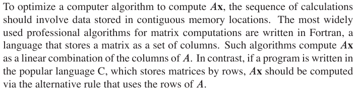

Fortran Can You Implement a Column-Major Matrix Storage Data Structure in C?
Implementing a column-major matrix storage data structure in C is feasible, despite C's default row-major order for arrays. The discussion highlights that while C arrays are stored in a row-major format, one can achieve a column-major layout by declaring arrays differently. The conversation also touches on performance considerations, suggesting that the choice of storage order can impact efficiency in matrix operations. Additionally, there is a debate about the naturalness of C's syntax compared to mathematical conventions, with some arguing that the syntax is not inherently tied to matrix representation. Ultimately, understanding these conventions is crucial for optimizing matrix calculations in C.

What this is saying is that for the definition below, C stores the elements in what is called row-major order.mafagafo said:See attached image.
I have never heard that before. Why wouldn't one be able to implement a data structure that stores a matrix by its columns using C? Is that true?
Code:
int arr[3][3] = {{1, 1, 1}, {2, 2, 2}, {3, 3, 3}};
So, no, the textbook is correct.

And even when the author says that "the most widely used algorithms (...) Fortran.", from what I have seen MatLab is pretty widely used both in industry and research and its implemented mostly on C.

It's not a question of what you can do in C, it is a question of what the compiler automatically does by default for you. M[row][column] is the most natural way to reference elements of a matrix M. In C if you want a matrix, M, to have an element in row=r and column=c referenced by M[r][c], then the compiler forces where those elements are stored consecutively:
M[1][1], M[1][2], M[1][3],... M[2][1], M[2][2], ...
The reason no one makes a structure to change the C order is that matrix calculations are easy to do efficiently the way it is now. It's easy to define loop calculations that use the matrix numbers from memory in sequence.
P.S. The advice in the book regarding the speed of calculations is very debatable. There are many steps and optimizations between your code and the speed of the resulting execution. There are look-ahead data fetches and guesses about which paths your code execution will take that make it virtually impossible for you to anticipate what will be fast.

mafagafo said:Yes, I get it. And pretty much every living creature also does. What I was telling you is that it is perfectly possible to get the same disposition in memory you would get in Fortran by just declaring each column in what would be each row. Then operate on that if it offers better performance.
The issue isn't Fortan's way of storing arrays being better than C's or vice versa. The languages simply follow different conventions which you should keep in mind when you write code that loops over arrays.
In C, the array element arr[2][2] is always directly followed by the array element arr[2][3] in memory. Technically, in terms of the C language definition and for the example array defined above, if p is a pointer to the array element arr[2][2], then p + 1 is guaranteed to point to the array element arr[2][3] and p + 3 points to the array element arr[3][2].
Fortran is a bit less straightforward. First of all, Fortran has no concept of pointer arithmetic, so there's no language-level way to define where array elements are going to be placed in memory. As far as I know, that means it's simply a convention that compiler writers follow to store arrays by column first in memory rather than by row. Second, even that convention isn't necessarily always true. I actually experimented several years ago with gfortran and passing arrays between C and Fortran to figure out what gfortran was doing with arrays. Here's what I remember for a two-dimensional array:
- Internally, gfortran creates two "multiplier" integer variables to keep track of where array elements are located. Calling the variables m and n, it would compute something like m * i + n * j to figure out where the array element arr(i,j) is located in memory.
[*]For a newly created array, m = 1 and n is set to the number of columns, so array elements in the same column are stored sequentially in memory.
[*]Certain array manipulation functions, like the transpose and array slicing functions, work by changing these values. For example, transpose(arr) works by interchanging the values of m and n rather than moving all the array elements around in memory.

Having been thinking on and off about this for half a day, I now believe that the quoted passage is fundamentally wrong on two accounts.
1. While not explicitly stating that, it suggests very heavily that Fortran's internal representation is superior. It has been pointed out in this thread that modern hardware makes this rather dubious. But more fundamentally, the statement is based on (assumed) performance of matrix multiplication. But that may not be a meaningful metric; a program solving a linear system or finding eigenvalues may not have a single matrix multiplication. Would Fortran's representation be superior in this case?
2. C has no intrinsic knowledge of "rows" or "columns". A multi-dimensional arrays in C is a block of memory with a particular relationship between indices and the address in the block. The programmer is free to interpret any index as a row or as a column. The situation is similar in Fortran, except that the relationship is not part of the language, but is an implementation detail. The programmer can assign "row" or "column" meaning to Fortran's indices regardless. In fact, so can a mathematician, provided that notation is consistent and well-defined.

The point isn't that one convention is intrinsically better than the other. It's that there's often different ways of looping over arrays that will produce the same end result, and where that's the case you should know which convention your favourite programming language/library/environment is using and try to loop in a way that will minimise how much you jump around in memory. As an example, suppose you have a large 5000x5000 element array and you want to do something with each element of the array. In C, you should iterate over the second index in the inner loop:
C:
for (i = 0; i < 5000; ++i) {
for (j = 0; j < 5000; ++j) {
/* Do something with arr[i][j] */
Fortran:
do j=1,5000
do i=1,5000
! Do something with arr(i,j)
end do
end do
If you're wondering why this matters, by the way, it's because there's more than one type of memory on a computer. Specifically, modern computers have one or more levels of processor cache memory, main memory itself, and virtual memory (i.e. a page file or swap partition on the hard disk), and there are big differences in how quickly the computer accesses each of these. If you write code that jumps around needlessly over a very large array, your computer could waste a lot of time copying stuff between cache and main memory or (worse) main and virtual memory.
That's not completely true. Fortran has a few built-in functions for matrix manipulation and these follow the standard mathematical (first index is row, second index is column) convention. So if you're storing matrices in Fortran rank-2 arrays, you should follow that convention if you want code like C = matmul(A, B) to work as expected.

Have you actually tried this? I just tested it out with GCC and the difference can be quite measurable.
Specifically, I compiled the code below (saved in a file called "arrloop.c") with gcc -O3 -o arrloop arrloop.c. I increased the array size to 20000x20000 to make the code run longer. Timing the resulting executable produces a result like this:
Code:
$ time ./arrloop
real 0m0.752s
user 0m0.223s
sys 0m0.526s
Same code except with the loop orders interchanged ("arrloop2.c") and same compilation option:
Code:
$ time ./arrloop2
real 0m5.853s
user 0m5.248s
sys 0m0.598s
There'll be some variation each time you run the code, but the difference is quite substantial: a few hundred milliseconds of user time vs. over five seconds.
