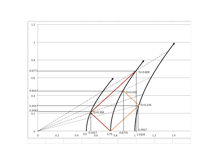

Thanks to all. I will respond to a number of the posts and then present an example (based on acceleration in SR) and hope that WannabeNewton or others will take it up and discuss it in GR terms (I am only beginning to learn the basics of GR, but hopefully the equivalence principle allows the SR example to illuminate something about GR).
The Shapiro delay is not currently incorporated into the GPS system, so it should not be captured by the references that Naty1 links. The signal propagation delay between Earth and satellites due to gravity is about 6 ps, which Ashby identifies as Shapiro delay. There is an additional 35 ps of cross link signal propagation delay due to gravity. Neither is incorporated yet. Here is a link on the effects, see slides 2 and 15: http://www.gps.gov/cgsic/meetings/2012/weiss2.pdf. Here is a piece explaining that the Shapiro delay was not incorporated into GPS because it was negligible: http://www.phy.syr.edu/courses/PHY312.03Spring/GPS/GPS.html .
Pervect's description of coordinate time accords with the analysis of coordinating clocks in a row of spaceships that accelerates Born rigidly (discussion of this at: http://en.wikipedia.org/wiki/Rindler_coordinates). But I do not see how this is relevant to the Shapiro delay.
The Shapiro experiment needs only one clock, a clock on the wrist of the experimenter. That clock records the elapsed time for a signal's out and back trip. That elapsed time is proper time; it is the wristwatch time of the watch on the experimenter's wrist.
I am not sure whether this involves "distant observation" as Naty1 mentions. There are only two observations: experimenter's wristwatch time when the signal departs, and experimenter's wristwatch time when the signal arrives back. Both observations are at the same place; neither is distant from the other. The light signal does travel a distance before reflecting and returning. Does this mean that the experiment measures the speed of light in a distant environment? Perhaps -- but every measure of the speed of light is an out and back measurement. There is no experiment that measures a one way speed of light.
Finally, the example. Say the Shapiro experimenter simultaneously sends signals in opposite directions, one toward the gravitational mass and the other away from that mass. In each case the flash travels the same distance then reflects and returns to the experimenter. The one that initially travels away from the mass will arrive first. It is not even necessary to utilize a clock or measure the speed of the signal. The fact that the forward signal arrives before the rearward one shows that signals traveling closer to the gravitational mass travel slower. If the experimenter measures the elapsed proper time for the two signals, the one that begins by traveling toward the mass will take a longer proper experimenter time to return than the one that begins by traveling away from the mass.
Attached is a diagram of three point mass spaceships beginning at rest in an inertial frame, then accelerating Born rigidly. The rear starts at x=0.5 and accelerates at proper rate 2; the center starts at x=0.75 and accelerates at proper rate a=1.33; the front starts at x=1 and accelerates at proper rate a=1. Upon beginning acceleration, the center ship simultaneously flashes light forward and back. The flashes reflect off of the other two ships and return to the center ship. The diagram shows four dashed lines of simultaneity for the row of ships at relevant points of the flashes' trips.
The forward flash returns first. Each leg of its trip (forward to the front ship, then back to the center) takes the same amount of proper center time (denoted Tc in the diagram) as the other leg (each leg takes Tc=0.216).
The rearward flash returns second. Each leg of its trip also takes the same amount of proper center time as the other leg (each takes Tc=0.304). The total proper center time for the round trips are Tc=0.432 for the forward flash and Tc=0.608 for the rearward flash.
The rearward light flash is slower than the forward light flash. This is not because of coordinate time. There is only one clock (the center ship clock), and it measures only its own proper time. Also, there is no need even to use a clock. All that the experiment requires is simultaneity; as long as the two flashes do not arrive simultaneously, then one is traveling slower than the other. You can change the rate of that clock in any way that you want to coordinate with any other clock in any other frame, and that cannot change the fact that the forward flash returns first; it is faster than the rearward flash.
There remains one important point, which is whether the distances between the ships stay constant during the acceleration; if they do not, then the conclusions above are not necessarily correct. By definition the distances remain constant in Born rigid acceleration. But the parts of Taylor and Wheeler in "Exploring Black Holes" that I have read so far explain that gravity is different in this regard -- the reduced radius around the mass is not the same as the radius. So perhaps it is the distance that is the issue, not the experimenter's proper clock rate.
Are you sure about that? How are you defining the distance?
According to local rods and local clocks the light always moves at c, so the distance according to local rods along the path is longer for the path that takes longer. It sounds to me like you must be talking about some coordinate distance which is the same, in which case that can be made to be a true statement regardless of the details simply by picking the appropriate coordinates.
Yes, if the coordinate distances are equal and you are talking about coordinate speed. That is certainly true in your chosen coordinate system, but I can always transform to a coordinate system where it is false.

I define distance in this example as the proper distance between the ships, that is the distance that the ships measure between themselves in their own reference frame. This is always 0.25. The ships start at rest in the inertial frame illustrated above at x=0.5, x=0.75, and x=1, hence the distance between each of them in their own frame is 0.25. Each then accelerates simultaneously, Born rigidly (at individual proper rates of acceleration that maintain their proper distance as measured in any momentarily comoving inertial frame). As wikipedia describes, "The defining property of Born rigidity is locally constant distance in the co-moving frame for all points of the body in question." http://en.wikipedia.org/wiki/Born_rigidity
Similarly, "Consider a uniform distribution of particles at rest along some segment of the x-axis of an inertial coordinate system x,t at the time t = 0. Each particle is subjected to a constant proper acceleration (hyperbolic motion) such that, with respect to its instantaneously co-moving inertial rest frames, the distances to each of the other particles remain constant. This condition is called 'Born ridigity' . . ." http://www.mathpages.com/home/kmath422/kmath422.htm
So, what the Minkowski diagram above shows is that in the proper reference frame of the three ships, and using the proper clock of the center ship, light travels more slowly when it travels in the area to the left of the center ship (and faster when it travels in the area to the right of the center ship). Both inputs to the calculation of speed are proper measures: proper distance between the ships in their own reference frame, and proper clock time on the the center ship's clock. But this example is in SR, not GR, and pervect refers above separately to distance (e.g., "local rulers"), and Naty1 refers above to space contracting.
Sorry, I guess I should have put more context into the quote. I was responding to your Shapiro delay comment. Not the ships.
EDIT: However, I guess that the question about how you are defining distance does apply to both the Shapiro delay scenario and the accelerating ships scenario. What you have shown with the ships is the well-known fact that the coordinate distance is not the same as the "radar distance" in the Rindler chart. So, again, the coordinate speed of light depends on the definition of your coordinates. The same thing happens in other non-inertial coordinate systems, such as rotating reference frames where the coordinate speed of light can be made arbitrarily fast or slow.
I am not sure if you are asking any specific question with your examples, or simply working through the concepts on your own.
Thanks. I am trying to understand the terminology. In SR the texts refer to proper distance (in the object's own frame) and length contracted distance (as the object presents in other frames in inertial movement with respect to the object). Posters in this thread refer to local, coordinate and radar measurements, and it is not clear to me what exactly they refer to. For example, what is coordinate distance v. radar distance in the Rindler chart, and how do they compare to proper distance?
Radar distance is a very general method of establishing a notion of distance between observers in a congruence of time-like worldlines within an arbitrary space-time.
The idea is as follows: observer ##O## in the congruence sends a light signal at an event ##p_1## to observer ##O'## in the congruence who immediately reflects the signal back to ##O## at event ##p_2## whereupon ##O## receives the signal at event ##p_3##; ##O## records the time ##\Delta \tau## between events ##p_1## and ##p_3## on a clock that he/she carries (i.e. the proper time along the worldline of ##O## between ##p_1## and ##p_3##).
The radar distance between ##O## and ##O'## is then ##L = \frac{c\Delta \tau}{2} = \frac{\Delta \tau}{2}## where I have set ##c = 1##.
One can easily compute this in Rindler space-time: the metric is ##ds^2 = - x^2 dt^2 + dx^2##. The congruence of Rindler observers is given by the vector field ##\xi^{\mu} = \frac{1}{x}(\partial_t)^{\mu}## i.e. the Rindler observers are exactly the static observers in Rindler space-time.
Now consider two Rindler observers ##O## and ##O'##, with ##O## at some ##x_0## and ##O'## at some ##x##. A null geodesic (light signal) originating at ##x_0## at time ##t_0## on the worldline of ##O## is given by (after a simple integration) ##ds^2 = 0 \rightarrow t - t_0 = \ln x - \ln x_0 = \ln \frac{x}{x_0}##. The light signal reflected by ##O'## clearly has the exact same form so the total coordinate time between emission and reception by ##O## is then ##\Delta t = 2\ln \frac{x}{x_0}## hence the proper time between emission and reception as read by a clock carried by ##O## is given by ##\Delta \tau = x_0 \Delta t = 2x_0 \ln \frac{x}{x_0}## therefore the radar distance between ##O## and ##O'## is ##L = x_0 \ln \frac{x}{x_0}##.
On the other hand the local ruler distance is given by ##dl = [(g_{\mu\nu} + \xi_{\mu}\xi_{\nu})dx^{\mu}dx^{\nu}]^{1/2} ##.
Local ruler distance has the following interpretation: say we have an event ##p_1## on the worldline of our Rindler observer ##O## and another event ##p_2## that is infinitesimally separated from ##p_1##. ##O## can connect these two events using a displacement vector (also called a separation vector) ##dx^{\mu}##; if ##O## wants to find the spatial distance between these two events then ##O## has to project ##dx^{\mu}## onto his/her local simultaneity slice and then take the length of this projection.
You can think of the projection of ##dx^{\mu}## onto the local simultaneity slice of ##O## as an infinitesimal ruler extending from ##O## at event ##p_1## to the event ##p_2##. Mathematically the projection is given by ##\eta^{\mu} = dx^{\mu} + (\xi^{\gamma}dx_{\gamma})\xi^{\mu}##
Note that this is just the orthogonal projection since the local simultaneity slice can be shown to coincide with the orthogonal projection at ##p_1##.
A simple calculation then shows that ##(\eta^{\mu}\eta_{\mu})^{1/2} = dl## so we are indeed finding the length of the ruler represented by ##\eta^{\mu}##.
Now ##\xi_{\mu} = -x(dt)_{\mu}## so ##dl = [g_{\mu\nu}dx^{\mu}dx^{\nu} + x^{2}dt^{2}]^{1/2} = dx##.
If we compute the radar distance between these two infinitesimally separated events then we get ##dL = x_0 \ln (1 + \frac{dx}{x_0}) = dx##, where I have Taylor expanded the ruler distance to 1st order.
So for nearby events the ruler distance and radar distance agree. However it is clear from the above discussion that for events that are not nearby (i.e. not infinitesimally separated), radar distance will not agree with ruler distance.
EDIT: In finding the radar distance, I assumed that the coordinate time for the light signal to go from ##p_1## to ##p_2## equals its coordinate time to go from ##p_2## to ##p_3##; this always works if the space-time is static, which Rindler space-time is.
In flat spacetime you can define the proper distance between two events or the proper distance between two worldlines at rest wrt each other. The proper distance between two spacelike events is the distance in the inertial frame where they are simultaneous. The proper distance between two worldlines is the distance between them in the inertial frame where the worldlines are both at rest.
In curved spacetime these notions no longer exist, however you can define the proper distance along a spacelike path as ##\int \sqrt{g_{\mu\nu}dx^{\mu}dx^{\nu}}##.
JVNY said:
OK, thanks. It would still be great if pervect would explain more about the coordinate v. local clocks (if still available and willing) because coordinate time does seem to be important. For example, Neil Ashby has stated that GPS time is an example of coordinate time, and I have read that the designers of the GPS system had to consider the possible effects of Shapiro delay (but determined experimentally that the delay was negligible).
I'm not sure what more I can explain. Coordinate clocks are defined by the coordinate system - if you change the coordinate system, you change the coordinate clocks. Thus they are a matter of convention. In general they don't have much physical significance.
Proper time represents the readout of a ideal clock following a specific worldline. A stationary, orbiting, or otherwise moving atomic clock would be an experimental measurement of proper time along the clocks worldline, at least up to the experimental accuracy of atomic clocks.
I hope the following observations will be helpful:
Being able to navigate, measure distances, and plan long trips on a sphere, such as the Earth, requires some knowledge of spherical geometry and to do the calculations, spherical trignometry. Explanations based in planar geometry just aren't going to be adequate.
Being able to navigate, measure distances, and plan long trips (including plotting the paths of radar signals over long distances) in a curved space-time, requires some knowledge of the Riemannian geometry of General Relativity.
If you want to travel short distances on the Earth, for instance if you want to walk to your local store, and you don't mind minuscule discrepancies in the measurements, you CAN "get away" without using spherical geometry - you can regard the Earth's surface as "locally flat", and draw a flat map on the plane, and get around OK. You don't need spherical geometry to plan a trip to your local store. However unless your accuracy requirements are very lax indeed, you do need spherical geometry to plan a trip from New York to London.
There is a way to do this in GR, as well.
In a small area, where you can approximate curved space-time as a flat plane, the coordinates with arguably the most significance are Fermi Normal coordinates. They are like a "flat map" of the surface of the Earth, as far as navigating through space-time.
A somewhat helpful reference (which does better at talking about the qualities of Fermi Normal coordinates rather than defining them in understandable terms):
http://arxiv.org/abs/arXiv:gr-qc/9402010
A very convenient property of flat space-time is the existence of Cartesian coordinates which are directly related to the experience of an inertial observer, and which are easily interpreted in terms of physical quantities like, e.g., distances. This concept should, in some sense, extend to curved space-time since actual observers are often accelerated and live in a (weakly) curved space.
There is a general agreement that Fermi normal coordinates are the natural coordinate system of an observer in general space-times. By this we mean coordinates which are most closely to Cartesian coordinates for general relativistic situations and which are related to observable quantities like acceleration, rotation, or distances. They were first introduced by M. Fermi in 1922
The paper's presentation of how you generate Fermi normal coordinates is probably too technical for the average reader, however. Even the simplest presentation is going to require some familiarity with the concepts of geodesics. (I'm not aware of any reasonably simple published exposition of them, and attempts in the past to present them with forum posts seem to have floundered because required concepts like geodesics are unfamiliar into too many readers).
A few other comments in a different vein:
A few lines from the reference
quoted earlier caught my eye:
Coordinate speed of light is generally slower than c due to Earth’s gravitational field
The length of a light path is the coordinate length plus the so-called Shapiro delay
This is pretty much the same thing I've been saying. The coordinate speed of light does , in fact, vary. This is true, but the remark has little physical significance because coordinate speeds have little physical significance.
An interesting point is the statement that they get a length by adding the shapiro time delay multiplied by "c" to the coordinate length. They don't justify this in detail, but it seems to be quite consistent with the viewpoint that the shapiro delay can be logically viewed in terms of the distance changing, rather than the speed of light changing.
This is great, thanks to all. A lot to read and work through. It does seem that distance is changing, and I will work through the various measures of distance.
