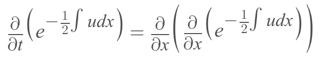

Attempt at a solution
To show φ satisfies our PDE, we first solve the substitution for φ
##\mathrm{ln(\phi) = -\frac {1} {2} \int u dx}##
which gives
##\mathrm{\phi = e^{-\frac {1} {2} \int u dx} }##
and plug it into our PDE, which simplifies to
##\mathrm{\frac {\partial } {\partial t} - \frac {\partial} {\partial x} u } = 0 ##

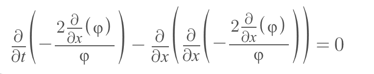

we use the substitution φ to show the following
##\mathrm{\frac {\partial } {\partial t} (\frac {-2 \frac {\partial} {\partial x} \phi} {\phi}) - {\frac {\partial ^2} {\partial x^2} (\frac {-2 \frac {\partial} {\partial x} \phi} {\phi} = 0 ##
so φ solves our PDE. To show u solves the Burger's equation with viscosity, we substitute u into the heat equation and simplify

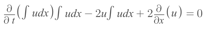

which is where I am stuck. It seems like this equation does not simplify to anything useful. What I am getting is the following.
