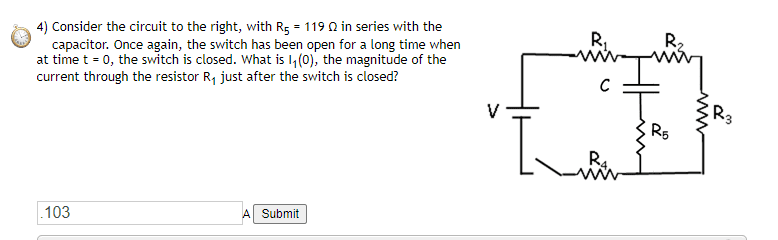

Consider the circuit to the right, with R5 = 119 Ω in series with the capacitor. Once again, the switch has been open for a long time when at time t = 0, the switch is closed. What is I1(0), the magnitude of the current through the resistor R1 just after the switch is closed?
I=V/R , Req=R235+R14
So what I know is that without the edition of the R5 resistor R2 and R3 are 0 because the capacitor is short circuiting them. Why does the addition of the R5 resistor cause R2 and R3 to be calculated into the Req for the current equation?
Likes Delta2
Adding R5 makes a difference because R2 and R3 are no longer shorted. Redraw the circuit with the capacitor as a "short" to find the initial Req and hence the initial current through R1 the usual way.
Thank you I kind of understand that, but how do I redraw the circuit with the capacitor as a "short". I don't really understand what that looks like
Likes Delta2
Replace the capacitor with a wire.
Likes mabdeljaber
Thank you! Understood
Likes berkeman
Maybe we have to explain why the capacitor at time t=0 behaves as a short. The reason is that the capacitor is assumed to be uncharged so its voltage is zero at this time instant. So if you apply KVL for the time instant t=0 you ll see that the resulting equation is like that the capacitor is a short.
If the capacitor had some initial charge or if we were asked for the current at another time instant then you shouldn't replace the capacitor with a short. You will had to solve differential equations then (unless the charge of the capacitor at that time instant was given).
