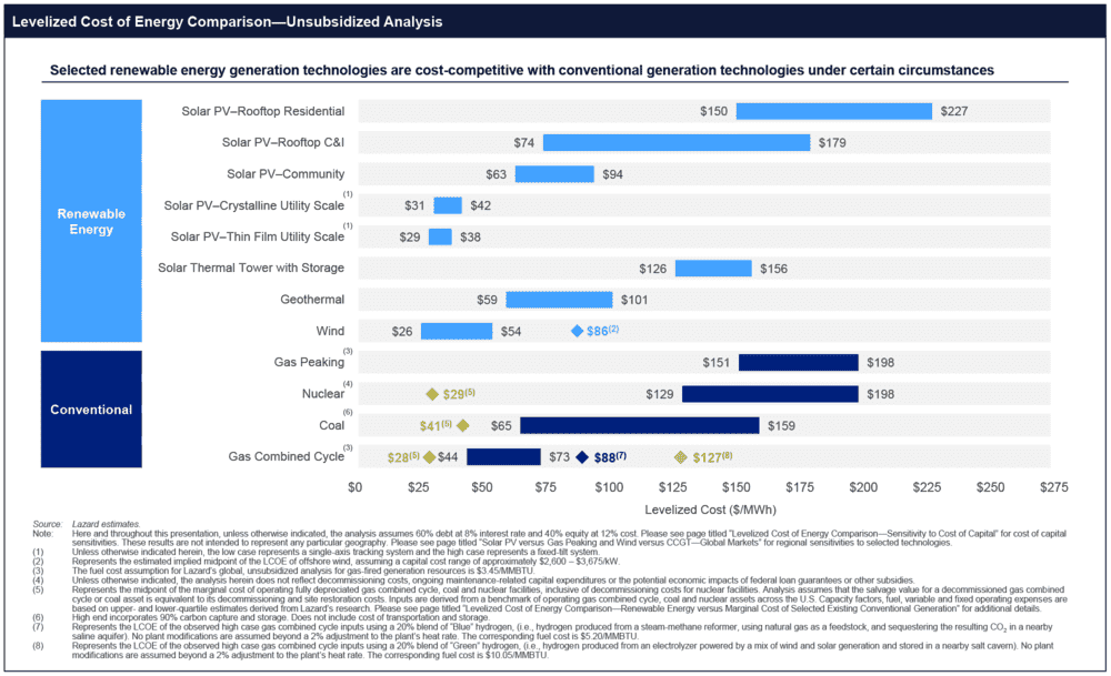

Your points 2,3,4, and 6 are all related to a real issue with nuclear power: the cost of new nuclear. As you are likely aware, the first nuclear plants in the US, before the creation of the NRC, were built relatively quickly in the hundreds of million dollar range (today's dollars). Now, Vogtle 3 and 4 will cost $15-16 billion with a ~ten year build time. It is this large cost that make the destruction of the Fukushima reactors a very large negative for a utility. By contrast, a new gas plant of similar size might cost a fifth the cost, can be built in 18 months, and does not require a large staff with "continual training", a security force, and permanent onsite regulators. So yes the industry is highly regulated, but is the particular US regulation appropriate? Does the current regulatory regime drive up costs unnecessarily and stifle innovation. Many new nuclear designs have been proposed, but recently DoE/NRC officials essentially testified that any non-light water reactor designs need not apply, though some of them could make a Fukushima type plant explosion not unlikely but impossible.
The point of nuclear power is to enable economic engines by means of clean and affordable energy; it should not be a jobs program.
