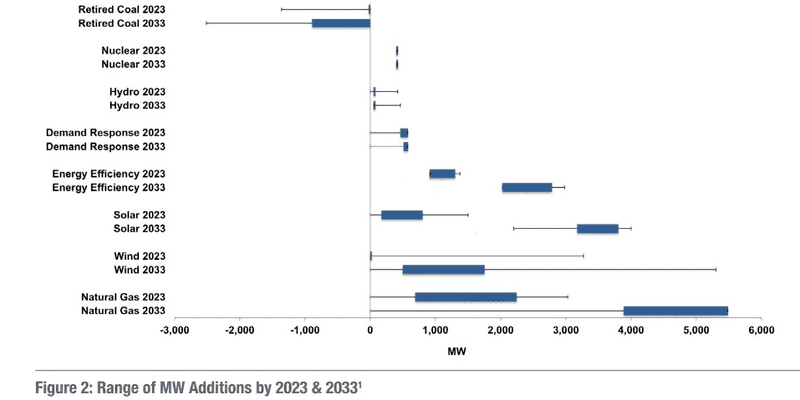

Thank you @Astronuc , that report did have the data I sought. I value it as an example of how future energy decisions are made in real life. They must conform to the expected realities, free of wishful thinking. They must accommodate a range of uncertainty about the future. They must convince potential bond holders that the plans are safe enough to invest in.
Here is a quick summary of the portions of the report that may be of interest to PF members.
It all begins with the load forecast which depends mostly on demographics and energy consumption trends.
https://www.physicsforums.com/insights/wp-content/uploads/2016/05/tva-peak-4.jpg
The figure below shows the primary end result of the study; the expected future mix of additions to generation types. Public forums expend many words expressing personal wishes about these numbers. These are the numbers that hard-headed planners really expect.
https://www.physicsforums.com/insights/wp-content/uploads/2016/05/slask-1.jpg
The plans are also checked for sensitivity to key variables whose future values are unknown. The wide lines in the plan show the planned ranges of the mix. The narrow lines show the extreme ranges that can be accommodated. They list which key variables they used to check the sensitivity.
  1. Changes in the load forecast
  2. The price of natural gas and other commodities
  3. The pricing and performance of energy efficiency and renewable resources
  4. Impacts from regulatory policy or breakthrough technologies
I thought it particularly interesting that the report included a "distributed marketplace scenario" which they defined as having 50% of TVA's industrial customers (representing 10% of TVA's load) switch to distributed self generation. That does not include residential rooftop solar. Since most public discussion about distributed generation focuses on consumer level DG, and never considers industrial DG, I think that's very notable. According to the study, industrial DG would have about the same drastic impact on gas prices as a carbon tax would. That's a connection that I never thought of.

Load growth forecast is most strongly coupled with GDP, and GDP forecasts are pressured by politicians and doomsayers to bend one way or the other. But utility load grows forecasts are not optimistic/pessimistic thinking but instead are mandated. Many facilities, including transmission, take 10-15 years from first proposal to operation. If a utility forecast zero or negative growth and that turned out to be wrong, the result could be a catastrophic shortage. That would tank the economy and make the lowball forecast the cause of the decline rather than a symptom.
In 2000, Enron in California demonstrated conclusively that having too little electricity available is vastly more profitable than having enough or having a surplus. If you like to believe that the utility industry is a conspiracy of greedy fat cats, then you should expect them to under-forecast the load.
On the other hand, if you believe as I do that the mantra of the industry is reliability (i.e. keep the lights on at all costs), then conservative assumptions about load growth are mandatory. Those conservative assumptions drive long-term projects to prepare for whatever the future may bring.
If you want to argue that the electric utility is in a death spiral, you can find support in some quarters. But you can't look for support in the engineering community. Engineering is necessarily conservative, and planning for a death spiral is not a conservative assumption.
