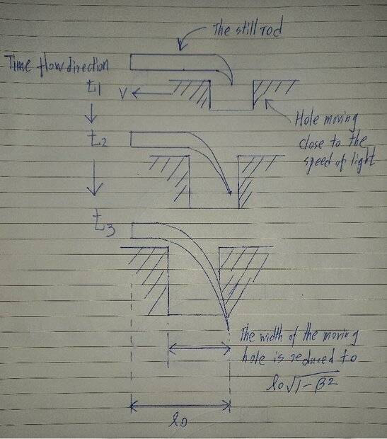

Yes, but if we imagine that the wall on the right side of the hole is a little lower than the left side, this extra clearance space is enough to accommodate the downward deformation of the rod, so that the rod does not fall into the hole, then the situation may be different?
In all frames of reference, the rod starts to bend as soon as it overhangs the edge.
In practice, something moving at this speed will travel a long way before it falls any distance under the usual gravity. This problem requires:
An infeasibly thin rod; an infeasibly thin surface; and/or, a massive gravitational force. It's very much a thought experiment from that point of view.
If the RHS of the gap is lower, then you'd need an even greater gravitational force to deflect the rod into the hole.
In any case, forces and stiffnesses of materials must be frame-dependent. This is a direct consequence of length contraction in the direction of motion. Analysing forces and accelerations in relativistic mechanics is the next step.
Remember that "stiffness" isn't some absolute quantity but something that is measured. An object may have a proper stiffness, as it has a proper length, but length and stiffness must be frame dependent. A metre stick traveling at very close to ##c## may have negligible length and be modeled more like a point particle.

alan123hk said:
But I think the degree of deformation of the rod will depend on the force measured by observer B and the stiffness of the rod itself, which may not be exactly the same as that calculated by observer A. Perhaps the degree of deformation is much smaller than the result of observer A's calculation.
When you speak of the deformation of an object, you are making a statement about where each part of that object is at the same time.
In a setup where the rod falls through the hole, for every point along the length of the rod there will be some event “this point on the rod passes below the level of the surface”. When we assert that the rod is not distorted as it passes through the hole, we’re asserting that all of these events happen at the same time; conversely if some parts of the rod drop below the level of the surface at more or less different times we find the rod more or less distorted.
Relativity of simultaneity means that “at the same time” is different in different frames, so the distortion will be different in different frames. No differences in forces or stiffness are required to explain the difference in shape.
You could save yourself a ton of grief and unnecessary exploration of increasingly complicated scenarios by thinking of the rod as a length of string instead. No matter what material it is made of, “string” will be a better approximation of its behavior than “rigid rod”.

alan123hk said:
still cannot give up thinking about this issue, because I believe that contradictions still exist. As the reply #20 has confirmed that the idea I described in #16 is basically not logically fallacy
That same post #20 also showed that your idea in #16 doesn’t lead to any contradictions. So please don’t use my post as a justification for believing that there is a contradiction. There isn’t.

alan123hk said:
all the observers in the different inertial systems are equal
That's not what the principle of relativity says. The principle of relativity says that the laws of physics are the same in all inertial frames. (Note that this is the SR version of the principle, which is all we need to discuss here. The GR version says the laws of physics are the same in all frames, even non-inertial ones. But that's beyond the scope of this thread.) But that does not mean that every scenario must look exactly the same in every frame. It only means that every scenario must be a valid realization of the laws of physics in every frame.
One of the laws of physics in SR is that anything that has to propagate can only propagate at a finite speed, the speed of light. "Anything that has to propagate" includes forces being applied; if a force is applied to one part of an object, that force can only propagate through the object at the speed of light, not infinitely fast. That is what prevents objects from being perfectly rigid in SR.
In this particular scenario, the scenario is set up so that the force that causes the rod to fall is applied to all parts of the rod at the same time in frame A. So the force doesn't have to propagate through the rod in frame A; it is already set up in that frame to apply the same force at the same time to all parts of the rod. So the rod does not bend in frame A. But by relativity of simultaneity, that means that force is not applied to all parts of the rod at the same time in frame B. And that means the rod must bend in frame B, because a force is being applied to only part of it at a given time, and that force can only propagate through it at the speed of light.
In other words, the scenario as it is set up is not completely symmetrical between the frames. And that is perfectly fine in SR! SR does not say that all scenarios must be completely symmetrical between all frames. It only says the laws of physics are the same in all frames.

PeroK said:
it bends as soon as part of it over the hole.
PeterDonis said:
However, this is false in frame A because the force that is making the rod fall is applied to all parts of the rod at the same time
I think PeroK is right when we're considering the most common description of the problem: the downwards force on the rod is its weight, resisted by the normal force from the surface except where the rod hangs over the edge of the hole.
PeterDonis is right when we're considering something like what @Ibix proposes in #12, where the downwards force is switched on across the length of the rod, simultaneous in one frame but no other.

Just to be clear it may be worthwhile to identify and describe the major versions.
The standard version is one where there is just a hole that the rod moves over. In that one the rod begins to bend as soon as the front end overhangs the lip of the hole. This bending occurs in both frames, so the rod is not straight in either frame. In both frames it crashes into the far wall.
Rindler’s version is one where there is a trap door that opens when the rear of the rod crosses the threshold. It is designed to open simultaneously across the hole in the ground’s frame. In this case the rod is straight in the ground frame. It falls after removing the trap door and therefore crashes into the far wall. In the rod’s frame the trapdoor does not open simultaneously, so the front of the rod starts falling before the rear does. The rod bends and crashes into the far wall. Rindler’s version is equivalent to the @Ibix version, just with the trap door being replaced with a piston.
The uninteresting version is the one you proposed above where the rod remains straight in the rod’s frame. This only can happen by covering the hole with something. In that case it is straight in both frames and does not crash into the wall in either frame.
The clearance version is the new one where the ground is not level, but is lower on the far side of the hole. This one depends entirely on how far from level it is. If it is sufficiently unlevel then there will be no crash in either frame. If it is just barely unlevel then there will be a crash in both frames. Either way both will agree.
I would recommend only discussing the original version or the Rindler version, and always being clear which you are discussing.

alan123hk said:
I still cannot give up thinking about this issue, because I believe that contradictions still exist.
but observer B has the absolute right to think that material properties, such as the stiffness of a rod at rest in his frame of reference, will not change due to its speed relative to other frames of reference.
Please consider Rindlers scenario with a trap-door, which makes the scenario easier to analyze.
In frame B, the stiffness is lost for a very short time, because:
  1. The left side of the rod is prevented from falling by the upward force from the (moving) tabletop and, in Rindlers scenario, for an additional distance from a trap door.
  2. The right side of the rod is falling by gravitation.
  3. The point, where the falling starts (by loosing support from the trap door), is moving with more than the speed of light to the left (* proof see below). That is faster than the speed, at which material-internal forces could react.
  4. The movement and length-contraction of the hole stops, as soon, as the right edge of the hole hits the right side of the rod.
The left edge of the hole is moving with velocity ##v## to the left.
* The trap-door is removed in frame A at time ##t=0##. That means with the Lorentz transformation:
##0=t= \gamma (t'+vx'/c^2)##
##x'/t' = -c^2/v##
The point, where the falling starts (by loosing support from the trap door), is moving with more than the speed of light to the left.
