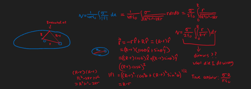

This comes from Griffiths' Electrodynamics and is problem 2.51 or 2.52, the disk has a surface charge density and my usual approach to solving these problems is to pick an area element and find a way to create a vector to the point(s) at which the potential is evaluated at. I sent a picture of my thought process and attempt at the problem. The solution involves a R^2+r^2-2Rrcos(theta) instead of R^2+r^2-2Rr that I have and I don't know how they arrived to that. Is my vector wrong or something else?
Here not Rr but ##\mathbf{R}\cdot\mathbf{r}##, an inner product, for [tex]|\mathbf{R}-\mathbf{r}|^2 =(\mathbf{R}-\mathbf{r})\cdot(\mathbf{R}-\mathbf{r})[/tex].
This makes a lot of sense now, thanks.
