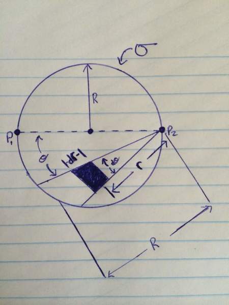

Find the potential on the rim of a uniformly charged disk (radius ##R##, charge density ##\sigma##). [Hint: First show that ##V=k(\sigma R/\pi\epsilon_0)##, for some dimensionless number ##k##, which you can express as an integral. Then evaluate ##k## analytically, if you can, or by computer.]
[tex]V = \frac{1}{4\pi\epsilon_0} \int \frac{\sigma da}{|\vec{r}-\vec{r'}|}[/tex]
where ##\vec{r}## is the position vector to the point at which the potential is being calculated and ##\vec{r'}## is the position vector of the charge.
Well, my first instinct was to jump in and do it brute-force with the above integral but I got stuck with a complicated integral with which even the computer struggled. After that I tried something simple - choose a convenient point on the rim rather than use a general one. Here I got a 0 for ##(R,0)## which doesn't seem right. Now, I didn't use the hint the problem gave me - I can't figure out from where am I supposed to get the ##R## in that equation (the other variables already appear in the formula above). I guess I could try to look for mistakes in the brute-force calculation but I am interested in a more elegant way of doing it which the hint seems to suggest.
Any thoughts on how to use the provided hint to solve this problem?
Thanks in advance!
Hmm the way I see it (assuming that 'rim' means not above the surface) you need to find some way to relate the distance ##r## between the point ##P## and ##dq##.
$$V = \int dV = k \int \frac{dq}{r} = k \int \frac{\sigma dA}{r}$$

Okay I think I have all the geometry for this figured out it was much more complicated than I initially anticipated. To find the potential on the rim:
$$V = \int dV = k \int \frac{dq}{r} = k \int \frac{\sigma dA}{r} = \sigma k \int_{- \frac{\pi}{2}}^{\frac{\pi}{2}} \int_{0}^{2R \cos(\theta)} \frac{r}{r} dr d\theta$$

Thank you! Could you elaborate on the limits in the last integral please? In particular the limits on ##\theta##.
$$\sigma k \int_{- \frac{\pi}{2}}^{\frac{\pi}{2}} \int_{0}^{2R \cos(\theta)} dr d\theta = 2R \sigma k \int_{- \frac{\pi}{2}}^{\frac{\pi}{2}} \cos(\theta) d\theta = 4R \sigma k$$
With ##k = \frac{1}{4 \pi \epsilon_0}##:
$$4R \sigma k = \frac{R \sigma}{\pi \epsilon_0}$$
which is what we were trying to find. The limits allow the coverage of the whole surface of the disk for an arbitrary wedge ##W## of length ##R## and width ##d \theta##.

Thank you, I get it now. Nice geometric trick.
I'll upload my doodle to help you see what's going on a bit more. You could have chosen any point on the perpendicular line through the center.
Thank you again. My confusion with the limits of ##\theta## was that I thought that for an arbitrary point on the rim it will not be from ##-\pi/2## to ##\pi/2## but now I see that ##\theta## is measured from the diameter and the latter can be rotated to fit any arbitrary point on the rim.
