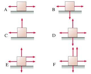

Assuming that in the tug of war Jackie is being pulled to the right, which of the free-body diagrams shown is correct?
Note that the forces are not drawn to scale. Also, they are not labeled; however, they should be labeled on your own diagram.
look at attached photo for above question
The best way to do this is to first think about the forces acting on Jackie. Try and write down all the forces you think are acting on Jackie, and in which direction they are acting. Then you should be able to deduce which diagram is correct. It is important to note that the diagram is not to scale.
