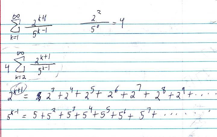

Problem: Indicate whether the series converges or diverges. If it converges, find its sum.
THE SERIES:
The ratio test and w/e equation is used to find the sum of this particular series
I was able to find that the series converges, using the ratio test. However, I cannot find the sum of the series. I do not see any way in which I could manipulate the geometric series, or anything like that. Could someone please enlighten me on how to find the sum of this series, or any series in such a form.
I don't think you need to do a lot of manipulation on a geometric series to find the sum. It should be pretty straightforward. Just factor out the k=1 term.
I have factored out the k=1 term...yet, I still do not know exactly what to do. I wrote out the series for both the numerator and the denominator, yet I do not see what to do next.
Here is my work:
Another hint at the problem solving process will be greatly appreciated.
Thanks.

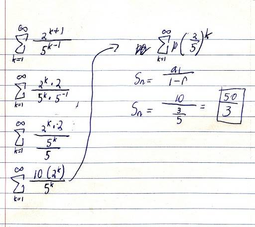

you could just write 2k+1=2k*2 and 5k-1=5k*5-1
Thanks for all the hints...but now, I have another problem. I obtained an answer of 50/3...however, the solution booklet says the answer is 20/3...
Here is my work:
Is this a typo in the manual, or is my answer truly wrong? If so, please tell me where I messed up.
The problem is that your sum is going from 1 to infinity, not zero to infinity. The formula for the geometric series that you used requires that the sum goes from zero to infinity:
\sum_{k=0}^{\infty}ax^k=\frac{a}{1-x}
But
\sum_{k=1}^{\infty}ax^k=\frac{a}{1-x}-a
