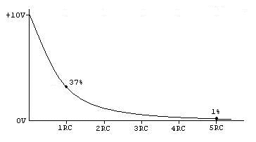

Another helpful mental picture is to understand that for each time constant ##\tau## the level of charge goes down to ##\frac{1}{e}## of its initial level Q. That is about 37% left after each time constant. So after one time constant Q goes to Q*0.37Q, after 2 time constants, Q has gone down to Q*(0.37)^2, and so on.
https://www.eecs.tufts.edu/~dsculley/tutorial/rc/dischargeCurve.jpg
