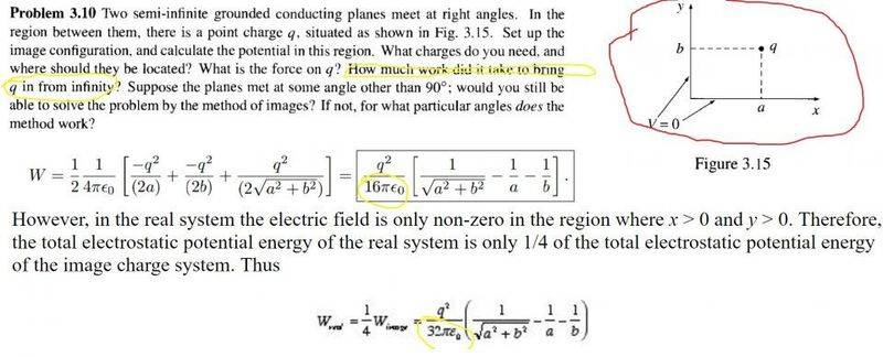

there are two different solutions in one question
! which one is correct??
the first one is written by griffiths
the second one is written by a lecturer.
they are not consistent in the same question
So which one is correct?
thank you

Well, in the preceding section Griffiths gives an alternative way to calculate the work !
It's not too complicated to integrate the force you calculated over the path bx = ay from ##\infty## to ##(a,b)## .
(And you can simplify by setting ##a=b## -- all you're after is factor of 2).
