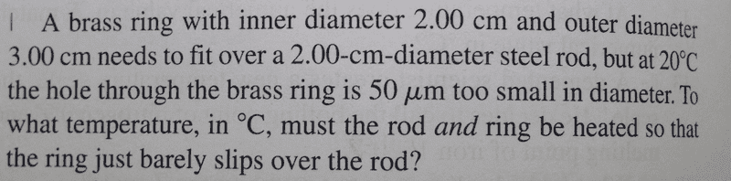

Thermal Expansion Problem Involving a Brass Ring
4 replies · 8K views · last reply
BrainMan
279
ΔL = LαΔT
What I did was to set the diameter of the inside of the brass ring + the change in diameter of the brass ring equal to the diameter of the steel rod + change in the diameter of the steel rod. So,
Lbrass + ΔLbrass = Lsteel + ΔLsteel
Where L is the diameter
Then I used ΔL = LαΔT to solve both ΔL's
Lbrass + LbrassαbrassΔT = Lsteel + LsteelαsteelΔT
Then I solved for ΔT and got
(Lbrass - Lsteel) / (Lsteelαsteel - Lbrassαbrass) = ΔT
Then since it states that the hole is 50 μM too small I did
(50 μm) / (Lsteelαsteel - Lbrassαbrass) = ΔT
I get a very small answer for ΔT but the answer says ΔT should be about 313 °C
I get about 370 from your equation (what coefficients are you using?). Please post your detailed calculation.
I did
(50 x 10^-9) / ( 0.020 * 1.1 x10^-5 - 0.020*1.9 x10^-5)
