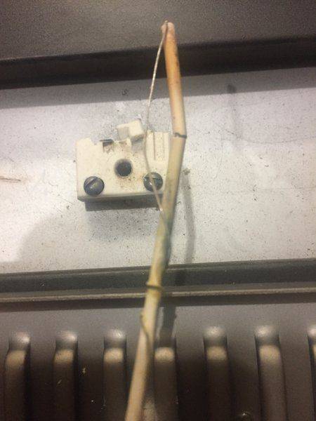

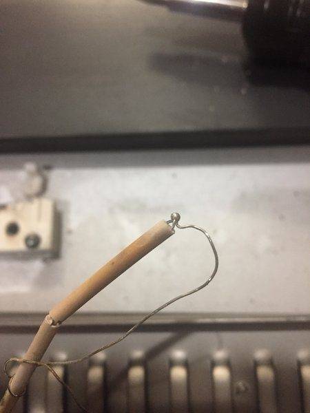

I have a type-K thermo-couple. In all the thermocouple, I have seen so far there is just two wires and a joint. But in the one I got, there is third wire which is connected to the joint and is twisted around the ceramic shield of the thermocouple. I do not know what does it do?
Any idea ...Thank you
Can you post a picture? What is the product model number that you bought? Can you post a datasheet link?

thank you for the response. I do not have a datasheet. I just found it in a very old furnace.

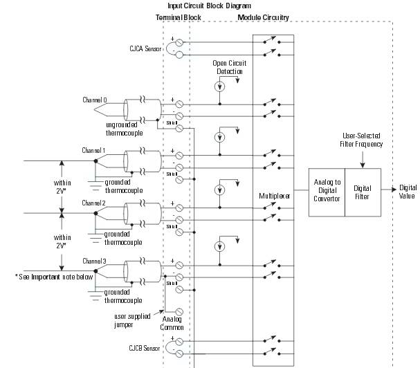

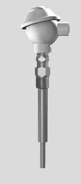

I'm fairly sure that this extra wire is for grounding via a thermowell (the ceramic wire separaters tells me the thermocouple is intended to be slide down a well.) i.e. the extra wire makes a connection with the inside of the thermowell which gets attached to some grounded equipment. Here's a thermowell that gets threaded into the equipment. They can also be permanently welded into the equipment.
From this Omega http://www.omega.com/technical-learning/preventing-vibration-damage-to-thermocouples-and-rtd-sensors.html:
Thermocouple junctions may be grounded or ungrounded. They are often covered with protective metal but may be left exposed to improve response time. Grounding is frequently required to prevent buildup of static charge, which may negatively impact accuracy.

Variations on the theme exist, but thermocouples come in grounded or ungrounded, and shielded or exposed junction types. On this one the junction is exposed, and equipped with a grounding wire.
If it were a shielded type (rather than being contained within a thermowell like the one @dlgoff described) it would typically be contained within a closed stainless steel or Inconel tube packed with magnesium oxide (to insulate the connection wires), and the junction would either be welded to the tip (grounded type), or offset back a bit to allow headspace for MgO insulation (ungrounded). In a shielded thermocouple, the grounded type has slightly faster response due to the direct connection between junction and sheath. An exposed junction TC has even faster response.

Thanks. The furnace does not work. I should find appropriate thermocouple and temp-controller to warm up the furnace. In the manual of this furnace they just said the typeK TC, thermal controller and heating element. there is well for the thermocouple with ceramic shield. Please find more captured photos for this furnace 's thermocouple.

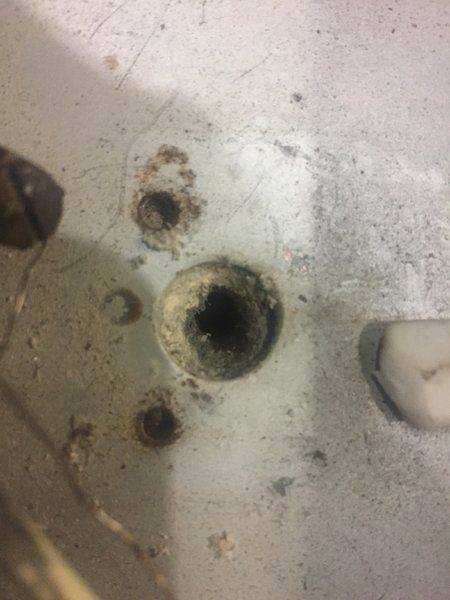

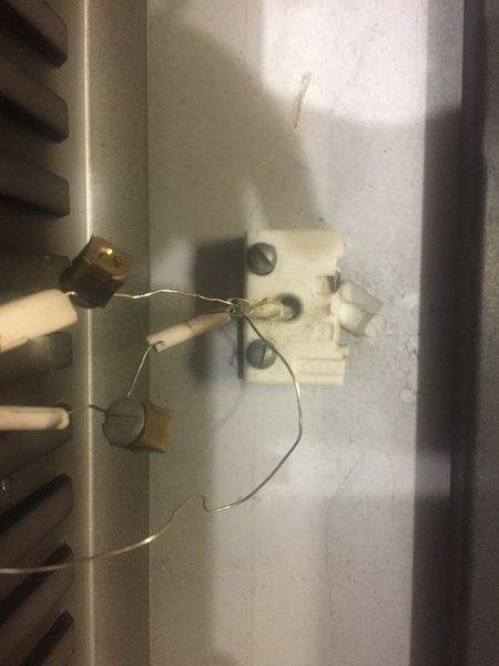

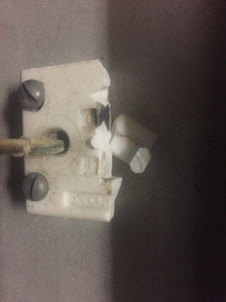

... it is an electric tube furnace for lab work (mm size ceramic fabrication). I hope every one could get it from the right point. I am not a technician.
What is the manufacturer and model number of the furnace?
  • What temperature is displayed by the temperature controller?
  • Does the controller have a lamp/LED/something else? that turns on to indicate when heating output is commanded on?
  • What is used for heater power control? A solid-state relay, electromechanical relay, or something else?
There is a good possibility the root cause of this 'does not work' problem is not, or at least not exclusively, a thermocouple issue.
I'm betting those brass (or perhaps copper) terminals were originally parts of the broken ceramic device the thermocouple extension wire runs through. What lies underneath looks like a thermally insulated pass-thru hole to route TC extension wire out of the oven chamber, and to the controller.
Wires from the TC itself, and TC extension wire are in contact with each another under the screw of each brass block. A thermocouple is formed any time two different metals come into contact with one another, and (if the wires weren't in contact with each other) each of these connections would exhibit thermoelectric behavior.
Generally speaking, the possibility of short circuits between wires is greater when thermocouple (+) and (-) and (in this case) ground wires are poorly insulated and in close proximity to one another (shown circled in red). This ought to manifest as a displayed temperature remaining suspiciously lower than expected - the measured temperature signal is an average of the intended thermocouple junction and 'false' thermocouple created where the wires have shorted together.

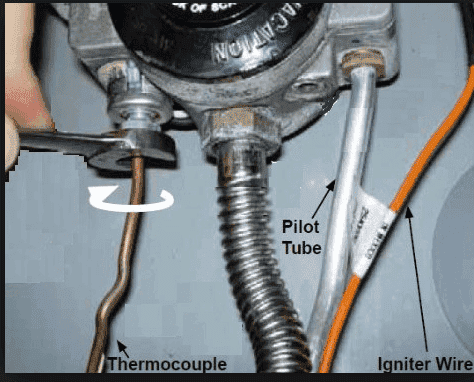

About 30 years ago, I had the thermocouple sensor in my gas furnace valve go bad. I knew enough to troubleshoot it down to that component (thermocouple was good), but the local repair outlet would not sell me the replacement part. I found a "thermocouple tester" in the hardware store, which consisted of this sensor and an indicator light, so I bought the "tester" and was going to use it to replace the bad sensor in the gas valve. If memory serves, there just wasn't any good way to get the valve apart to replace that component, so I think I ended up with a whole new gas valve anyway. Or maybe I was able to fix it, I just don't remember.
But it happened again a few years ago in my newer home on a ~ 15 year old furnace. This time, it was clear that there was absolutely no way you could take that valve apart to replace any component. In one way, I was mad about that - it seems a shame to throw away an entire valve because one little $5 component was defective. But after thinking about it some more, I realized that if that component could be replaced, it could also be by-passed. And if it can be done, some one will do it. So I resigned myself to the idea that safety for all was more important than my being able to do a repair.

Ahh an electric kiln of sorts.
A thermocouple in proximity to sizeable electric heaters - grounding it seems a good idea.
I never encountered one like that, mine were in thermowells like the one dlgoff posted.
Some of them look like a copper tube going into the valve
My local hardware store carries them in several lengths
https://www.robertshaw.com/ProductDetail.aspx?id=2147492934&cat=2147484248
Replacing the thermocouple is about all you can do to them .

Yes, I think it was my bad that from the beginning I did not mentioned the details. but it is an experience for me any question must be in details.
yes it will be connected to a temperature controller. The problem is here. The out put of thermocouple to a temperature control unit must be two. But as you can see in the photos there are 3. I still do not know what is the reason for that.
The two wires going to the brass terminals are (+) and (-) thermocouple output. The third wire is unexplained, but may have been intended to ground the thermocouple.

I agree with @Asymp
it would make sense to ground a thermocouple that's in proximity to high powered electric heaters.
Especially if it's not in a thermowell .
But machinery is full of surprises...
If we knew the nature of the device that reads the millivolts we could venture better guesses.
old jim

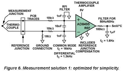

My guess the third wire is to help with noise imunity while preventing the whole thermocouple from floating. I would think there would be better noise immunity when this third wire is grounded back at the amplifier/transmitter than just grounding it at the weld. I would think of it as a shielded twisted pair microphone cable.
