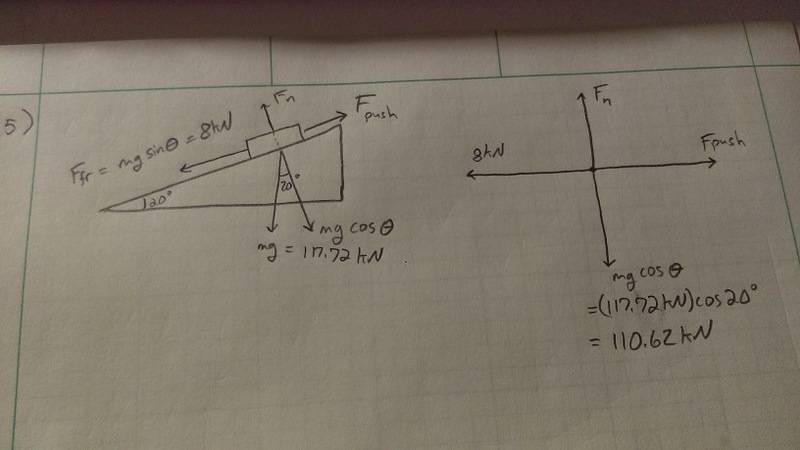

Oh I believe I know what I'm doing wrong. I didn't realize that the friction force is equal to the horizontal component of gravity. Here is a new FBD:
If this is correct, then Fpush (force required for the train to go up) is equal to 8kN?
Also, where would the 30% efficiency come in? Would be applied to the work I will find?
It's not. There are two downward forces that must be overcome by the engine: gravity & friction. Add them to find the total force. (The friction force is given; you need to calculate the component of gravity.)
Oh oops, okay so there are two horizontal components acting to the left. Friction and mg*sin(20). So Fpush = 8kN + 40.26kN = 48.2kN.
For work, the distance would be:
d = 750/sin(20°) = 2192.85m
And so the work would be:
w = Fd = (48.2)*(2192.85) = 105.83kJ
Now where does the efficiency come in?
Good, but be careful with units. (I think you dropped a factor of 103.)
