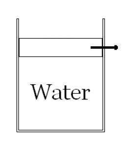

An insulated cylinder containing water has a piston held by a pin. The water is initially saturated vapour at 65°C and a volume of 5L. The piston has a total mass of 10kg, its area is 0.003 m^2 and the atmospheric pressure is 100kPa. The pin is then released, allowing the piston to move. Determine the final pressure and temperature of the water assuming the process to be adiabatic.
[/B]
Sum of forces = 0
F = PA
W = mg
At equilibrium:
P2 *A = mg + Patm *A
P2 = mg/A + Patm = 10*9.8/0.003 + 100*10^3 = 132666.6667 Pa = 1.326666667 bar
That's the first part done. Now I'm stuck at the second part - finding the final temperature of the water (T2). This is what I've got so far:
V1 = 5 L = 0.005 m^3 (given)
v1 = 6.201 m^3/kg (using the Steam Table)
m1 = V1/v1 = 0.005/6.201 = 0.00080632156 kg
P1 = 0.2501 (using the Steam Table)
Q12 = 0 (adiabatic; insulated)
However, I don't see how any of this is relevant to finding T2. Any help is much appreciated.

Hey guys, thanks a lot for the replies!
Chestermiller said:
This is an irreversible process, so the ideal gas law can't be used. Let V2 be the final volume. In terms of V2, how much work did the gas do?
Q-W = DeltaU
Q = 0 since the process is adiabatic
h = u+PV -> u = h-PV
Therefore:
W = -DeltaU = m(u1-u2) = m (h1 - P1V1 - h2 +P2V2) (1)
Is this right? h2 is unknown...

I can confirm that the final state of water is in superheated vapour form, according to the answers.
Q-W = DeltaU
Does your steam tables not have internal energies tabulated, only enthalpies? If so, see below.
Therefore:
No.
##W=(V_2-0.005)(132.7)## kJ
##\Delta U=-W=-(V_2-0.005)(132.7)##
##\Delta H=-(V_2-0.005)(132.7)+132.7V_2-(25.01)(0.005)=(107.7)(0.005)## kJ
v2 = V2/m
Correct.
From equation (1):
w = h1 - P1V1 - h2 +P2V2Sorry I don't really understand this part. What I got is:
u2 = h2 - P2V2
but h2 is unknown.
Consider this:
$$h_2=h_1+\frac{\Delta H}{m}=h_1+\frac{(107.7)(0.005)}{0.000806}$$
So, you now know the final pressure and the final enthalpy per unit mass.
This is the only part that I do not understand. Why is the pressure constant here? W=PΔV only applies to isobaric processes. P2 has a magnitude of 1.32 b while P1 has a magnitude of 0.2501 b, which I have already determined in the OP. Clearly there is a pressure difference so why are you using the formula for work for an isobaric process?
Anyway, I got the correct answer thanks to your help. Just don't understand the isobaric part!
LostStudent5 said:
It does, but it's in the form of uf and ug. I can work out u1 with the given data, but not u2 since its state is unknown.
My question too, Chet! Why is pressure essentially constant and equal to the final equilibrium pressure? Otherwise I think I follow.
In an irreversible compression like this, the gas pressure within the cylinder is non-uniform spatially, and, in addition, viscous stresses within the gas contribute to the force per unit area exerted by the gas on the piston face. It is this force by the gas that does the work on its surroundings. So, the ideal gas law cannot be applied to get the gas force on the piston face.
In addition, in this problem, the gas force on the piston face clearly varies with time. So, how does one proceed? Well, we if we apply Newton's 2nd law to the piston, we obtain:
$$F(t)-mg-p_aA=m\frac{dv}{dt}$$where F(t) is the force exerted by the gas on the piston at time t, m is the mass of the piston, A is the piston cross sectional area, and ##p_a## is the air pressure. If we multiply this equation by the piston v=dx/dt, we obtain the mechanical energy balance equation: $$F\frac{dx}{dt}-mg\frac{dx}{dt}-p_aA\frac{dx}{dt}=mv\frac{dv}{dt}=m\frac{d(v^2/2)}{dt}$$
If we integrate this equation with respect to t, we obtain:
$$\int_{0}^{x(t)}F(x)dx=\left(\frac{mg}{A}+p_a\right)(V(t)-V(0))+m\frac{v^2(t)}{2}$$
The left hand side of this equation is the work done by the gas on the piston between time zero and time t, and the last term on the right hand side of this equation is the kinetic energy of the piston at time t. At relatively short times, the piston will overshoot the equilibrium position and oscillate up an down, so its kinetic energy will be varying with time. But, as time progresses, the oscillation of the piston will be damped out by viscous dissipation caused by the viscous stresses within the gas. (There is no need for actual friction between the piston and the cylinder to bring about this damping, and, in this analysis, we assume that the contact between the piston and the cylinder is frictionless). So, at very long times, we will have:
$$W=\int_{0}^{\infty}F(x)dx=\left(\frac{mg}{A}+p_a\right)(V(\infty)-V(0))$$
But this equation is exactly the same relationship we would have obtained if we had assumed that the gas force on the piston face were constant at its final equilibrium value throughout the entire expansion/compression.
