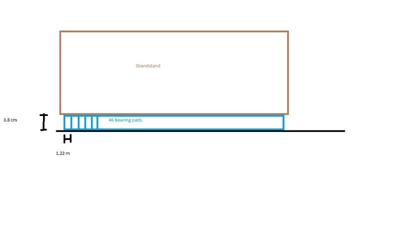

Denver's Mile High football stadium incorporates a system by which a section of stands can be moved to accommodate different sports on the field. The grandstand, which has a mass of 4x10^6 kg, can be moved a distance of 45 m on a thin film of water. The movable grandstand rests on 46 bearing pads that are each 1.22m in diameter. Water at high pressure is pumped into each of the pads until the stands are lifted a vertical distance of 3.8 cm. Excess water forms a lubricating film over which the grandstand is moved. The force required to move the stands is approximately 4.45 N per 450 kg of staduym mass. Calculate the following:
a. The pressure of the water under each bearing pad
b. The power of the motor required to move the grandstands over the distance of 45 m if the job takes 1 h.
c. the work required to raise the grandstand 3.8 cm.

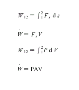

See attachment formulas. Here is a brief description of each:
1. Force-displacement work
2. Force-displacement power
3. PdV work (piston)
4. PdV power
Am I picturing this problem correctly (see "picture" attachment)?
I don't understand the bearing pads part. Do the bearing pads move or are the bearing pads wet and the grandstand slides on the bearing pads? And for part (a) asking the pressure of the water under each bearing pad, does this mean the water pressure inside each pad? I'm very confused about this problem and don't even know where to start. Any help would be appreciated. Thanks!

Equations 1 & 3 are correct, but 2 & 4 are not.
For #2, recall that W = F·d, where d is the displacement.

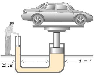

I'm also not clear on whether the bearing pads move or are stationary, but I think that's not necessary for answering the questions. Yes, they would mean the water pressure inside each pad. Each pad is acting as a hydraulic lift, similar to in this picture:
To help get you started: how much force must each bearing pad exert on the grandstand in order to lift it?

I think the 46 bearing pads can be treated as one single pad, as the effect is the same. Also the 1.22m diameter is extra unnecessary information right?
