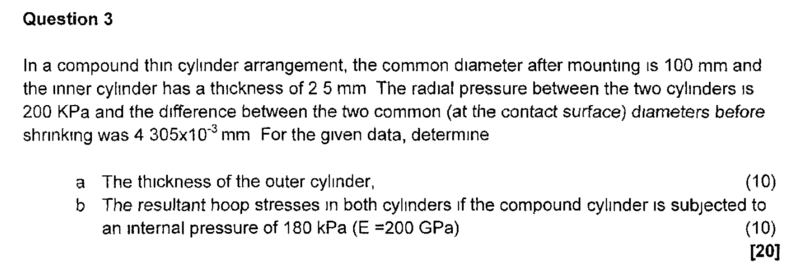

Note: inner cylinder thickness = 2.5mm
difference between common diameters before shrinking = 4.305x10^-3mm
a) I am not sure where to start without either the inner or outer cylinder diameter but I think I need to use the following:
The sum of the changes in diameters of the two cylinders is equal to the interference between the diameters before shrinkage:
Δd1+Δd2=4.305x10^-3mm
Pd1/2t1 + Pd2/2t2=4.305x10^-3mm
Please help me get started

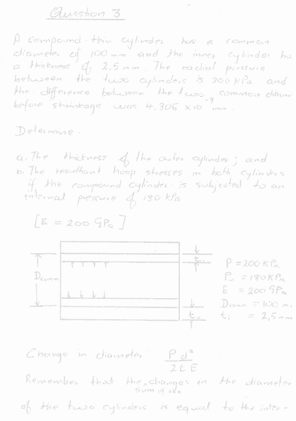

edit the answer give for part a) is 2mm
Although the info E=200GPa is mentioned in part b, you will need this in part a.

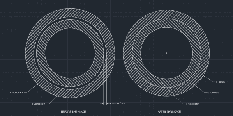

I imagine something like this:
I could be (most likely) wrong so I really don't know.
All I do know is that the thickness of the outer cylinder must equal 2mm, I just don't know how to get there.
DevonZA said:
Unfortunately no diagraM.
With set-up as you draw it, there would be no pressure between the two surfaces and no basis for calculating the other thickness.
Try my version.
Try my version.
Ah yes that makes sense.
