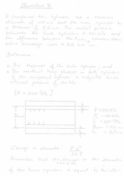

Thickness of a cylinder in a compound thin cylinder
The discussion revolves around the thickness of a cylinder in a compound thin cylinder setup, focusing on the relationship between the inner and outer cylinders, their diameters, and the effects of pressure and thermal expansion. The problem involves understanding the interference between the diameters before shrinkage and how this relates to the material properties and dimensions of the cylinders.
  • Participants explore the relationship between the changes in diameters of the two cylinders and the interference before shrinkage. There are attempts to clarify the roles of tension and compression in the context of the problem. Questions arise regarding the setup of the cylinders and the assumptions made about their interactions.
The discussion is ongoing, with participants providing insights into the mechanics of the problem. Some guidance has been offered regarding the relationships between forces and stresses, but there is no consensus on the specific approach to take. Participants are encouraged to think algebraically rather than numerically, and several interpretations of the cylinder arrangement are being explored.
There are constraints related to the provided information, such as the lack of a diagram and the specific values for material properties. Participants express uncertainty about the correct equations to use and the implications of the given parameters on the problem.

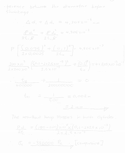

  • #36
haruspex said:
Ok, so express the strain, ε, in terms of ri and R.
Then get an expression for the circumferential stress, σ.
Hi Haruspex
sorry for my delayed response.
Please see the answer provided by my lecturer below:
  • #38
haruspex said:
Looks like the same approach I was trying to lead you through, just done in a different order.
As long as the answer is correct :)
Thank you for your help.
  • #39
If I am too late, sorry. Just working on this question myself now.
σc=(Pd)/(2t)
the circumferential strain ε=σ/E = (Pd)/(2tE) but εc= (πΔd)/d
diametral strain εd=Δd/d
∴εc=εd the change in diameter = (Pd^2)/(2tE)
The sum of changes in the diameters of the two cylinders is equal to the interference between the diameters before shrinkage.
∴(Pd^2/2tE)inner + (Pd^2/2tE)outer = 4.305x10-3
∴((200x103)(0.0952))/((2(0.0025)(200x109))+((200x103)(0.12))/((2(t)(200x109))=4.305x10-6
1.805x10-6+(5x10-9)/t=2.5x10-6
to=0.002m = 2mm
b) Not sure about this part...
Now consider the inner cylinder:
inner pressure of 180 kPa and radial pressure of 200 kPa from outside
σc=pd/2t = ((180000-200000)(0.095))/(2x0.0025)
= -0.38 MPa

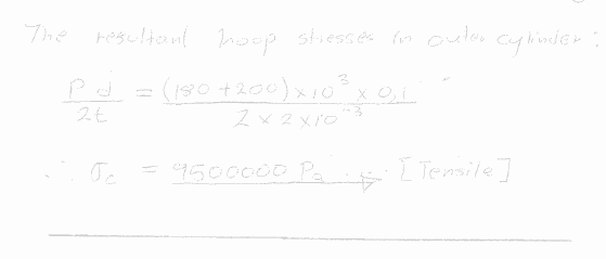

consider outer cylinder:
180 kPa+200kPa
σc=pd/2t = ((180000+200000)(0.1))/(2x0.002)
= 9.5 MPaThe first part I could confirm with answer in my textbook, but the second part I had to trust is correct..
  • #40
Ah, I missed the second page of comments with all the answers on...
Well, confirmed my own answers, so thanks!
