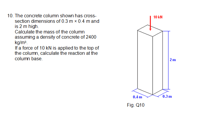

Think the Mass is correct, unsure on Reaction Force

Isometric line drawing of a tall rectangular concrete column, 2 m high, with a red arrow labelled 10 kN pressing down on its top face; base sides labelled 0.4 m and 0.3 m.

kg/m3 = mass / volume
Downward forces on the column = Weight + Additional force
(F=ma)
[/B]
Therefore, 2400 = mass / (0.3 x 0.4)
Mass = 576 kg
(F=ma) = (576 x 9.81) + 10 kN
= 15.7 kN
Every force has an equal and opposite reaction (Newtons 3rd Law). Hence the reaction force at the base of the column = 15.7 kN
The volume of the concrete is 2 m * 0.3 m * 0.4 m = 0.24 m3.
oh ok so does that make the volume 1000?
I meant 0.24 sorry
1000 what? Always use units.
What I wrote was very plain: the volume of the concrete ... = 0.24 m3. No more. No less.
sorry yes i did not realize you had worked it out . Thanks.
So would this now make the total mass 1000kg?
Therefore (1000 x 9.81) + 10 KN = overall 19.8 KN ?
Math aside for the moment, the so called reaction force at the base has nothing to do with Newtons 3rd law. Rather, it is a consequence of his first law, from equilibrium considerations. This is a very important distinction.
You seem to be confused by the meaning of density.
Since concrete has a density of 2400 kg/m3, this means that a 1 m3 block of concrete has a mass of 2400 kg.
If you want to calculate the mass of concrete contained in a solid rectangular block, you must calculate the volume of the block, which is what I showed in Post #2.
The formula for density ρ is ρ = M / V, where M is the mass and V is the volume.
For concrete, ρ = 2400 kg/m3 and I showed you how to calculate V. Solve for M. :wink:
