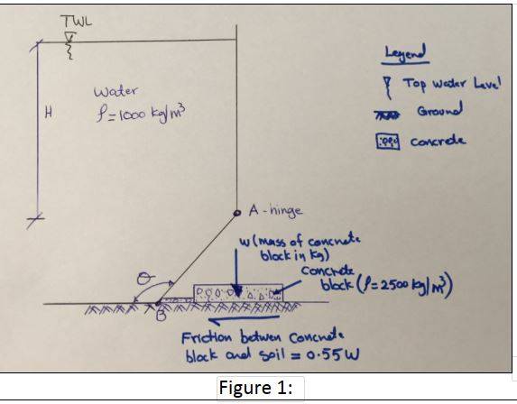

Calculate the concrete volume that is required to keep the sluice gate AB closed, assuming that the only resisting force is the friction between the concrete block and soil. The sluice door is square (900 x 900 mm) and hinged at point A (refer to Figure 1).
Use a factor of safety of 1.5.
Take density of water 1000 kg/m3 and concrete 2500 kg/m3. Assume the friction between the concrete block and soil is 0.55 x concrete mass
Height/H = 5.4m
Degree = 140
My working out is:
Sine 140 = AC/0.9 AC = 0.9*sin40 = 0.579m
y = 5.4 + (0.579/2) = 5.6895
A = 0.9*0.9 = 0.81m^2
R = pgyA = 1000*9.81*0.81*5.6895 = 45.2093 kN
D/Magnitude = sin^2 (IGG + A (y/sin)^2 / A *y)
sin140^2 = 0.413
IGG = bd^3 / 12 = 0.9*0.9^3 / 12 = 0.0547m^4
D/Magnitude = 0.413 (0.0547 + 0.081(5.6895/0.643)^2 / 0.81*5.6895) = 5.688m
I am now perplexed an confused on how to find the volume of concrete to keep the gate shut.
Would it be:
R*(FE + EA) = W*0.55
sin140 = D - y / EF EF = D - y / sin140 = 5.688 - 5.1105 / sin140 = 0.5775m
EA (Middle of gate) = 0.9/2 = 0.45
45.2093*(0.5775 + 0.45) = W*0.55
W = 84.459 KN x (1000/9.81) = 8609.5 kg
I do not know how to get the concrete volume and how will I use the factor of safety

Hand-drawn schematic of a sluice gate AB hinged at A, with water of density 1000 kg/m3 to the left up to top water level TWL, depth H, and a concrete block of density 2500 kg/m3 on the ground at B with weight w and friction 0.55w, angle theta 140 degrees.

  • Hand-drawn schematic of a sluice gate: water of density 1000 kg/m3 behind a vertical gate of height H from the top water level, hinged at point A, angled to the ground at angle theta, with a concrete block of density 2500 kg/m3 at its base resisting friction with the soil.
If you know the mass of concrete, they give you the density. Therefore you can find the volume.
There are several errors in your calculation: always carry the units and carefully cancel them to assure correctness. Get in that habit starting now...please redo.

Please include units in every calculation. Every term in every entry. You have still made multiple errors and I personally am not going to chase them down.

Here I think I am going wrong. Do I just multiply the 3751.07 by 0.55 then divide by the density of the concrete (2500) to get the volume?
Convert weight into mass
Mass = 3751.07* 9.81 = 36798 kg
Volume of Concrete = Mass/Density = 36798/2500 = 14.72 m^3
every number has units. write each of them down. you will discover your mistake...if not I will gladly look at the effort

All these units above are done and everything seems fine as I have followed the formulas I was given.
The errors I assume are here:
Here I think I am going wrong. Do I just multiply the 3751.07 kg by 0.55 then divide by the density of the concrete (2500 kg/m^3) to get the volume?
I have done changes here:
Volume of Concrete = Mass/Density = 3751.07kg / 2500 kg/m^3 = 1.5 m^3
What are the units on each side of the "=" for this?

This makes no sense:
JimCrown said:
Sine 140 = AC/0.9m AC = 0.9m*sin140 = 0.579m
Put units in for Newtons (kgm/s2) and see if this is incorrect
JimCrown said:
W = 36.798 KN * (1000kg/m^3 / 9.81m/s) = 3751.07 kg
When I suggest putting units in, the purpose is to compare each term and see that it makes sense (one cannot add meters to seconds...). So you need to redo this calculation and check each line as it is written for dimensional consistency by reducing to similar units (time length and mass are most usual) . Like the lines above And you need to get in that habit every time you calculate (or do algebra). This is like practicing scales on a piano...soon you will do it automatically and it makes life much easier.

R is the Force:
I meant to put EF as FE. And EA is the middle of the gate. The units are fine after checking through everything and so are the sums until a certain point when I do not know what I am doing.
Describe your approach in maybe five steps and indicate where it goes off the rails (and what you don't understand). I think at the point in question you are equatinq torgue to Force...no can do..
The first calculations are all correct and follow the formula I was given. I am having trouble when I reach here (mainly how to find out the volume of concrete) I believe it to be 1.5 m^3
I am not equating torque with force I just think we are having a serious miscommunication:I am not sure if this is correct though? As I believe everything is correct until I reach:
