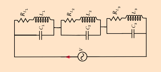

(Number of turns)^2Back to the original question ... What if stray-capacitance is added , (see attachment) ,
could that cause the middle coil to become the hottest at some resonant-frequency ?

If C2 is a tiny capacitor and C1 and C3 are large capacitors the the currents through the inductors would not be equal.
On the other hand, Assuming the capacitors are reasonable parasitic values, Power factor will cause some variation, won't it? Any AC guy care to work that out?
The keyword for me was parasitic. IMO, the parasitic capacitances won't change the situation.
But the mutual inductances would change the situation if the inductors were stacked end-to-end.
Quiz Question -- if the inductor slugs were stacked end-to-end, how would that change the heating situation?
