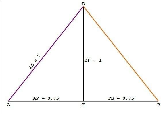

"Why doesn't light travel further in the slowed time". Light always travel at the speed of light.
There are two frames here.
1. Train frame
2. Platform frame.
According to the observer waiting on the platform -> platform frame is a rest frame, train frame is the moving frame.
According to the passenger on the train -> platform frame is a moving frame, train frame is the rest frame.
"Why doesn't light travel further in the slowed time with respect to (wrt) platform frame?". I think there are two objects in your question.
Light trajectory: Is the path the light takes wrt platform. Platform will see the light travels at 300,000 km/s. It cannot go further or shorter.
Time clock: Is the clock on the train that is seen by the platform: Platform will see the clock at the train slows down.
Perhaps you can answer this question, so you'll understand it.
Supposed there is a train. Its wide is 300 000 km. Or its wide is the distance light takes in 1 second. We'll call it its wide is 1.
The platform length is 450,000 km or 1.5
The train travels at 0.6c
When the train starts moving, a passenger in the train turns on his/her flash light toward a mirror at the other side of the car, 300,000 km away.
1. How much time does the train takes to reach the edge of the platform at 450,000 km away?
2. What is the light path as seen by the platform observer?
3. What is the light path as seen by the passenger?
So, you'll realize why "the light doesn't travel further at the slowed time"
  • Geometry diagram of a triangle with vertices A, D and B, D at the top and F on base AB. Vertical line DF = 1 meets AB at F. AF = 0.75 and FB = 0.75. Side AD is labelled AD = ?.

Consider this scenario:
Speed: 0.6c; gamma = 1.25
Train car width: 300 meters
Train travels from point A to B then stop:
AB distance is 450 meters. wrt platform
Time wrt platform = 2.5 micro seconds
Light path (hypotenuse) wrt platform: 375 * 2 = 750 meters
AB distance is 360 meters. wrt train, is this relevant to the discussion?
Time wrt train = 2 micro seconds, for light to bounce back from the mirror at the other side of the car
Light path (train width) wrt train : 300 * 2 = 600 meters

Can I stay with my simple experiment? The passenger sees the light travel exactly the length of the train and records, say, a millionth of a second. The platform sees the light travel the length of the train, plus the distance the train has moved. Because both agree the light travels at c, more time will have elapsed for the platform observer.
This may not be the scenario you're interested in, but I'm aiming for the utmost simplicity.
Yes. I agree 100% with your points. As a matter of fact, I have already drawn the picture in post 2. But I'll upload it for you again.
Diagram of a light-clock path: a vertical line DF of length 1 meets a horizontal base AB at F, with AF = 0.75 and FB = 0.75; a purple line AD is marked AD = ? and an orange line DB joins D to B.
Supposed, the width of the train is 300,000 km, we'll say that it's 1.
The length of the platform is 450,000 km, we'll say its 1.5. Half of the platform is 0.75
Train speed is 0.6c
The passenger sees light travel DF * 2 distance.
The platform sees the light travel AD * 2 distance.
What is AD distance? ##AD = \sqrt{DF^2 + AF^2} = 1.25##
So in 1.25 sec wrt platform the train has traveled 0.75. 2.5 sec wrt platform, train = 1.5
So, 2.5 seconds wrt platform is 2 seconds wrt train.
It seems that you have understood SR (btw my SR is very weak :smile:), so I don't have to tell you the diagram and the problem in detail.
DF length is 1.25. It conforms gamma factor ##\gamma = \frac{1}{\sqrt{1-v^2}}##
Btw, where is the OP anyway?
Very neat! It shows how useful Pythagoras was to Lorentz and Einstein.
