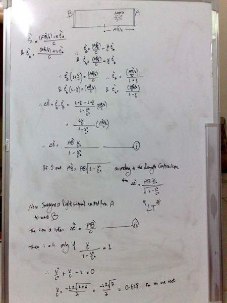

Adel, I'm going to stick to the train frame and give some names to things so we can be clear about what we are discussing:
IN THE TRAIN FRAME
A and B are the two ends of the train.
C is the point somewhere between them where there is a light source.
p is the event "a light signal is emitted at C".
q is the event "the light signal from C reaches A".
r is the event "the light signal from C reaches B".
What you seem to be claiming is that it could be possible to send a light signal from A after event q that will reach B before event r. Am I correct?

Are you doing this for his original scenario in post #1 or for the one in post #22? Or are they supposed to be the same or related in some way?

Thank u for your care to clarify things for me. But my scenario is different from just assigning events to different coordinates in different frames. I posted here a clear detailed diagram and calculation based on my idea. Even from the diagram it is clear that A and B are still spacelike for the train observer because the source is put near to A than B which means that Signal must reaches B in no later than a signal would have taken to reach B coming from A. But how about the math! I see no contradictory to insert ∆t``= (AB`)/c and equating it with ∆t`= (AB`v/c2)/(1-(v2/c2)) can you? In other words, if A and B are spacelike for the train observer, why the math of LT allows the time difference between receiving signal at both ends to equal the time difference a light signal would take to reaches B from A?

Adel Makram said:
yes correct
Without using any relativistic calculations it's easy enough to see that this is impossible. Just put a mirror at A.
But you seem to be claiming that relativistic calculations show this to be possible. In order to understand your argument I need more explanation. In the PDF you just attached, what exactly do you mean by t`a and AB` ? In what frame of reference are you doing your calculations?

I know that it is impossible from the diagram and the experiment setup. So the physics says it is impossible but the math says it is possible!
AB` means the distance between A & B in the train
ta` is the time when A received the signal from the source
All calculations are done in the train rest frame

Δt` is the difference in time of receiving the light signals at A and B
Δt`` is the time that would have been taken by a light signal emitted from A to reach B
Have you read any of my posts? I've been telling you lots of times that there's no such thing as a distance between A and B in the train's rest frame, if A and B are events that are simultaneous in the ground's rest frame.
OK. I imagine that v is the velocity of the train relative to the ground?
Please could you explain the reasoning behind the first step in your PDF, where you state that:
[itex]t`_{a} = \frac{(\frac{1}{2}AB`)-vt`a}{c}[/itex]

Then why is there a "v" in the calculations and in your diagrams?
The speed of the light source has no bearing on anything except maybe to determine its location at the time it emits a flash which means you could analyze your scenario with the location of the light source as a variable instead of the way you are doing it, correct? Then instead of something special happening at v/c=0.618, it would happen at some position of the light source, correct? And then you could tell us what that location is and you could show us what the something special is, correct? Why don't you do that?

v is the velocity of the train relative to the ground, yes. But it is also the velocity of a source put in the ground moving with -v relative to the train if the location of that source coincides with the point of the source in the train at the beginning of the experiment. This I missed to mentioned at the PDF. So the light emitted from a source in the ground corresponding to a point in the train near A than B.
This also gives the answer to your second question. That is when the ground source coincides with the midpoint of the train relative to the ground observer, their light signal would reach A and B at the same time relative to him. It must coincides too with the center of the train relative to the train observer ( because the world lines of the source and the midpoint of the train coincide in all FORs) So ta` is the time recorded by the train observer when the light strikes A and tb` has the same meaning for B

You only addressed my first question and you didn't even answer it:
Adel Makram said:
ghwellsjr said:
v is the velocity of the train relative to the ground, yes. But it is also the velocity of a source put in the ground moving with -v relative to the train if the location of that source coincides with the point of the source in the train at the beginning of the experiment. That is I missed to mention in the PDF. So the light emitted from a source in the ground corresponding to a point in the train near A than B.
My question was: why, since "all calculations are done in the train rest frame" do you need "v" in those calculations?

You have to be very careful here. We can distinguish 4 events:
Event 1: light flash is emitted.
Event 2: the middle of the train coincides with "position p" in the ground frame.
Event 3: the light reaches A
Event 4: the light reaches B
In the ground frame, events 2, 3 and 4 are simultaneous. In the train frame, they aren't: they happen in the order 3,2,4.
The two world lines meet at event 2, but I don't see where this helps us in the train frame: in this frame (as remarked above) this is not simultaneous with either event 3 or 4.
Yes, but that doesn't explain your first equation.
You are right I made my calculation based on Events 2 & 3 and Events 2 & 4 are simultaneously. So how the wrong math leads to the correct LT?

  • #54
Isn't it the case that the source of light emits a single flash at an instant of time? If this is true, why do you care where the source moves to after the flash has occurred? Couldn't the flash be emitted by a flash bomb that ceases to exist once it is set off? And if this is true, why do you care about its state of motion prior to it being set off?.
Firstly, I do not need it from the point of view of the train observer. But mathematically, I need a correlative tool with the ground frame so as to compare what will be the expected difference in time between A&B with an expected difference if light would have been emitted from A to B as a function of v! Exactly like the derivation of LT. so if every observer observes sequences related to light transmission from his frame point of view no LT would had ever come!
Secondly, this math could be considered as follow: The ground observer calculate what the train observer would see. So he must includes v
ghwellsjr said:
I think if you actually do what I'm suggesting, that is, break your scenario into two parts, one for the train with the flash occurring at a specific point and one where the speed of the ground observer determines where that point is, you will discover that at your special speed of 0.618, the flash actually occurs at location A and for higher speeds, it occurs to the right of A. But I don't know, because I still cannot figure out the second part of your scenario.
If the flash occurs at A, the light takes the same time to reach B that the source takes to reach the mid-point. In this case the v/c=0.5
ghwellsjr said:
You still have not told us where the train observer is located on the train or where the ground observer is located with respect to the light source.
There are 2 train observers at A and B
But there is just one ground observer to observe all events from the point where midpoint of the train coincides with the source
It doesn't! Your results for t`a and t`b are incorrect.
There's a simple relation between t`a and t`b which you can use to check your result. I'll label with "C" the place on the train from where the light flash starts. It's clear that the distances add up like this:
[itex]CA`+ CB` = AB`[/itex]
[itex]CA`[/itex] is [itex]t`_{a}c[/itex] and [itex]CB`[/itex] is [itex]t`_{b}c[/itex], so:
[itex]t`_{a}c + t`_{b}c = AB`[/itex]
and therefore:
[itex]t`_{a} + t`_{b} = \frac{AB`}{c}[/itex]
Since [itex]t`_{a}[/itex] and [itex]t`_{b}[/itex] are both positive (light isn't going backwards in time!), it's clear that their difference can never exceed [itex]\frac{AB`}{c}[/itex].
