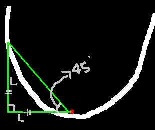

In the above figure, what would be the time period of the body(in red) under gravity, neglecting any non-conservative forces?
And what do call this type of situation? A gravity well or sth?

Okay, I think we can work something out here. Hope you're familiar with calculus :smile:
Let L be the length defined by
Height above valley bottom = Horizontal distance from valley bottom​
I.e., to find L, draw a 45 degree line from the red dot. The line will intersect the curve at the height L.
The level or height of the ground, above the valley bottom, is then given by
[tex]\begin{align}<br /> & y/L = (x/L)^2 \\<br /> \text{or} &\\<br /> & y = x^2 / L<br /> \end{align}[/tex]
(Check for yourself that this equation has the two desired properties: (1) it is a parabola, and (2) y=L when x=L)
Now apply Newton's 2nd Law for the horizontal (x-direction) motion:
[Edit: added cosθ term below]
[tex]\begin{align}<br /> ma & =F \\<br /> \\<br /> m \frac{d^2x}{dt^2} &= -mg \sin \theta \cos \theta, \\<br /> \end{align}[/tex]
where θ is the angle of the slope.
If we restrict the motion to small-amplitude oscillations (i.e. x is much smaller than L), then we can make the approximation
[tex] \sin \theta \cos \theta \approx \theta \approx \tan \theta = \frac{dy}{dx} = \frac{2x}{L}[/tex][Edit: added cosθ term above]
Substituting this for sinθ in the earlier equation, we get
[tex]\begin{align}<br /> m \frac{d^2x}{dt^2} &= -mg \frac{2x}{L} \\<br /> \\<br /> \frac{d^2x}{dt^2} & = -\frac{2g}{L}x \\<br /> \end{align}[/tex]
This is a well-known differential equation, with the particle oscillating sinusoidally at angular frequency
[tex]\omega = \sqrt{\frac{2g}{L}} \text{ in radians/second}[/tex]
So the period of oscillation would be
[tex]T = \frac{2 \pi}{\omega}<br /> = 2 \pi \sqrt{\frac{L}{2g}} [/tex]
Using g≈10 m/s2, you can calculate the period for, say L=0.3 meter -- or about 1 foot, the size of a hole you might dig in the ground with a shovel.

But I didn't quite get the y and x, what are they defined to be?
I mean how do they go into the geometry?
And I don't understand what
L = Height above valley bottom = Horizontal distance from valley bottom
means. Do you mean something like this:
X and y would be your normal Cartesian coordinates which are not in your picture, but need to be.
Your description of L is correct.

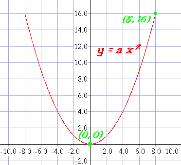

We know that we are trying to express a parabola, with it's minimum point -- the red dot in your figure, or the bottom green dot in the figure below -- located at the origin (x=y=0). This is really the picture you drew already, but here is an example including x and y coordinates:
In general, every parabola like this can be expressed mathematically in the following form:
[tex] \frac{y}{\text{something}} = \left( \frac{x}{\text{something}} \right) ^2[/tex]
... and then we have to figure out what the two "somethings" are to get a final expression.
We have to know the value of some point on the parabola in order to plug numbers into the "somethings" above. The green dot at the upper right of the figure tells us that the point (x=8,y=16) is on the parabola, so we can use the 8 and 16 in the equation:
[tex] \frac{y}{16} = \left( \frac{x}{8} \right) ^2[/tex]
It's important to realize two things about the above equation:
1. It describes a parabola (due to the x2 )
2. It is a correct equation for (x=8, y=16)
And doing some algebra, we get
[tex]\begin{align}<br /> y &= 16\left( \frac{x}{8} \right) ^2 \\<br /> \\<br /> y &= \frac{16}{8^2}x^2 =\frac{16}{64} x^2\\<br /> \\<br /> y &= \frac{1}{4} x^2 \ \ \text{ or, equivalently, } \ \ y = 0.25 \ x^2<br /> \end{align}[/tex]
So that is the equation of the parabola. By the way, you may notice that the point (4,4) is located on the parabola as well. So we could have used 4 for each "something", and we would have ended up with the same result. (In this example, the value of L would be 4.)

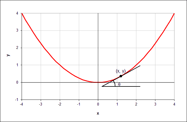

See the attached figure, showing a parabola with length scale of 4. At the point (x,y), the parabola has some slope, as indicated by the black diagonal line.
θ is the angle of the sloping line from the horizontal. And tanθ gives the value of the slope, i.e. [itex]\frac{\Delta y}{\Delta x}[/itex] or "rise over run".
