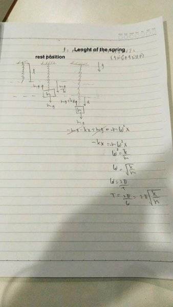

a man sits in a car that makes the center gravity of the car is pulled down by 0.3 cm. After he gets out of the car, find the time period of the car while it is moving in SHM
Mass of the car = 500kg
Spring constant = 196,000 N/m
I know that mass and the spring constant, both affect the time period of the object but how is their equation?

I found this equation
T=2π(SQRT*K/M) but I don't know if it correct or not. I plugged the the spring constant and the mass in the equation, I got about 124.33 s, I think it is too high for the time period

I got it from another physics group
haruspex said:
Can you not see the error in the very last step?
When he converted ω is equal to 2π/T?
then it should be
ω = (SQRT*k/M)
2π/T = (SQRT*k/M)
T = 2π / (SQRT*k/M)
am I right? I used this equation an I got about 0.317 s
That works. The answer looks good.
The formula is usually written as ##T = 2 \pi \sqrt{\frac{M}{k}}##.
In the scanned page that you attached in post #5 there was an error in the final step of the derivation, as pointed out by @haruspex. It resulted in the argument under the square root being the reciprocal of what it should.
