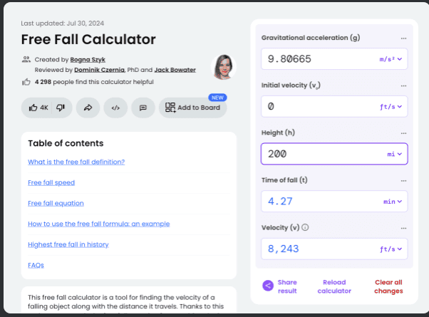

I tried out this free fall calculator, and it says that it would take 4.3 minutes to fall to Earth from 200 miles up. (The altitude of the space shuttle, but no horizontal velocity.) This intuitively seems very fast to me, even assuming no atmosphere. Am I using it wrong?

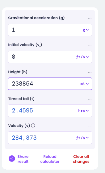

It also gave me a very wrong answer for the moon falling to Earth. I suspect that this is because it does not adjust the gravitational acceleration to account for distance. Is that right? I think the correct answer should be about a week. (1/4 the time it takes for the moon to orbit the Earth.)

For the first question, assuming ##g## doesn’t vary much from its usual value on the surface, 4.3 minutes is about right. This assumes the object dropped is not in orbit, it just drops from rest 200 miles high. The Moon is in orbit so that is an entirely different situation. Think about what being in orbit means.
You can check this for yourself. From the SUVAT equations we have ##s=\frac{1}{2}at^2##, it is not unreasonable to treat ##a## as constant over this distance (for extra credit, estimate the error resulting from using this approximation), solve for ##t##.

On the other hand, assuming constant acceleration all the way out to the Moon is unreasonable. This assumption leads to 2.4592 hours. Perhaps the calculator is using a non-standard value of ##g## to arrive at 2.4595 hours. It shouldn't be arriving at that value at all; the assumptions leading to this value are invalid.
Yes, of course. I was responding to the first question, the one about the 200 mile fall - and for that one we can reasonably advise OP to calculate instead of relying on "intuitively feels very fast".
When I see a discrepancy in the fifth significant digit I generally suspect careless rounding, limited precision arithmetic, or the like. But without access to the source code, it's hard to say.... I've just seen enough naive floating point to be reflexively skeptical
Yep.
That is correct. Sometimes you do get what you pay for when you use a free site, which is nothing.
It's a bit less than a week; I get 4.83 days.
