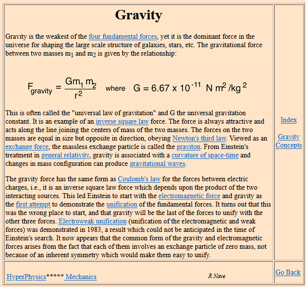

Sorry, what does that mean? Are you familiar yet with the equation for the gravitational force between two masses?
$$F = \frac{Gm_1m_2}{r^2}$$
http://hyperphysics.phy-astr.gsu.edu/hbase/grav.html
