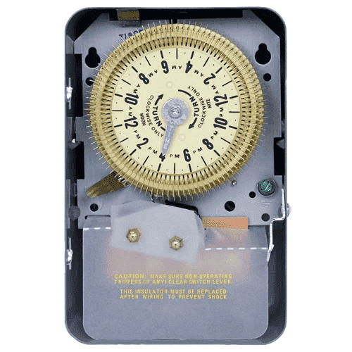

Sure, plenty of ways to do this, but it is difficult to say without a better understanding of the specifics. For example, if this is a 600V bank then size a contactor to suit (check the contactor manufacture's recommendations) and control the contactor with a 24 hour timer along the lines of the Intermatic pictured below, or program an intelligent relay such as a Siemens Logo! to do the job.
I considered this things, but this all are rated at 240vac, whereas our line is 415vac, 50hz, 3 phase.

Control voltage transformer need only be sized large enough to handle contactor coil inrush current (plus whatever else may be connected to it - indicating pilot lamps, timer, and whatnot).
Work back from the contactor specifications, for example, if the contactor coil is rated 220V, 70 VA inrush and the timer consumes 5VA, a transformer rated 150 VA will easily handle the load.
Have you looked into any Intermatic timer specs? I don't know what they may offer in 415V/50 Hz, but their 60 Hz timer product line includes 480V timer motor supply with 20 amp contacts rated for up to 480V AC operation, and will easily handle a contactor coil. Be sure if you use a motor-based timer like this that the motor is rated 50 Hz, or the timing will be thrown off.
