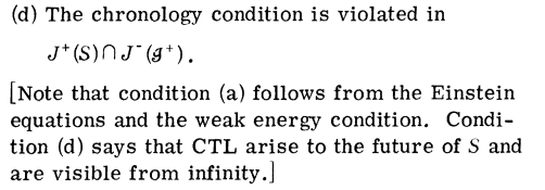

I'm reading Tipler's 1976 paper, "Causality Violation in Asymptotically Flat Spacetimes" and he keeps using a symbol which seems to resemble the symbol for Future Null Infinity in a strange font, but it's usage doesn't make sense with what I would expect if that's what the symbol meant. He doesn't define it anywhere in the paper, so I assume it must be standard notation that I'm missing. The symbol in question is the one that in the first photo we're interested in the causal past of, and in the second photo, we're evaluating at the point q.
##J^-(X)## is the region visible from ##X##, so ##J^-(\mathfrak{I}^+)## would be the region visible from infinity, which matches up with the text you quote. What's the problem?
I'm not clear on what it means when he takes ##\mathfrak{I}^+(q)##. Is it just the set of null rays going off to infinity that pass through q?

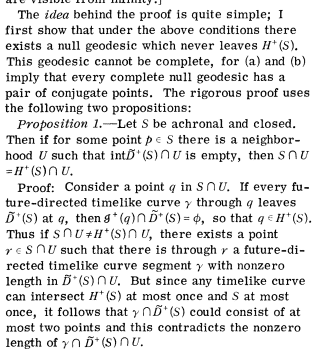

Will do: the relevant paragraph is here:
The questionable notation is in the Proof section of the proposition.
I presume ##\tilde{D}^+## is the closure of ##D^+##? I'm also not sure what ##\phi## is supposed to be, unless it's meant to be the empty set symbol ##\emptyset##. If so, I think ##\mathfrak{I}^+(q)\cap\tilde{D}^(S)=\phi## makes sense in context if interpreted as ##{I}^+(q)\cap\tilde{D}^(S)=\emptyset## - i.e. if ##\mathfrak{I}^+## is a typo for ##I^+##.
If anyone disagrees with me they're probably right - I'm literally doing this with my phone in one hand and Wald in the other.
From what I've been able to find online, the symbol ##\tilde{D}(S)## is the same as the usual symbol for domain of dependence, but only for timelike curves rather than any causal curve, according to this stack overflow post:
https://physics.stackexchange.com/q...pment-or-future-domain-of-dependence-why-is-d
The symbol is from Hawking and Ellis, apparently.
