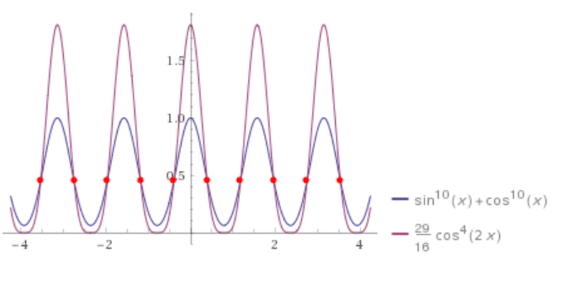

Here's what it looks like graphed out:
Graph of y = sin^10(x) + cos^10(x) in blue and y = (29/16)cos^4(2x) in purple over x from -4 to 4, with eight red intersection points marked on the curves.
  • Graph of y = sin^10(x) + cos^10(x) in blue and y = (29/16)cos^4(2x) in purple over x from -4 to 4, with eight red intersection points marked on the curves.
