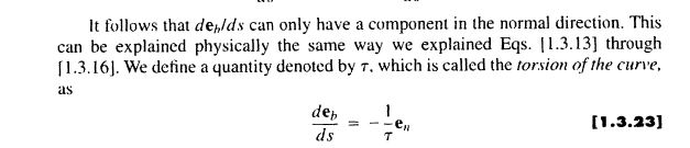

Understanding Torsion of Curve: Normal Unit Vector Explanation
The discussion focuses on the torsion of a curve and its relationship with the normal unit vector, specifically through the application of the Frenet-Serret formulas. These formulas provide a mathematical framework for understanding space curves by defining the tangent vector as the derivative of the curve's functional definition with respect to arc length. Additionally, the formulas generate two orthogonal vectors, creating a co-moving orthogonal reference system essential for various engineering applications.
PREREQUISITES- Understanding of vector calculus
- Familiarity with the concept of space curves
- Knowledge of derivatives and their applications in geometry
- Basic grasp of orthogonal vectors and reference systems
- Study the Frenet-Serret formulas in detail
- Explore the application of torsion in engineering contexts
- Learn about the geometric interpretation of space curves
- Investigate the relationship between curvature and torsion
Students of vector calculus, engineers working with space curves, and anyone interested in the mathematical foundations of curve analysis.
