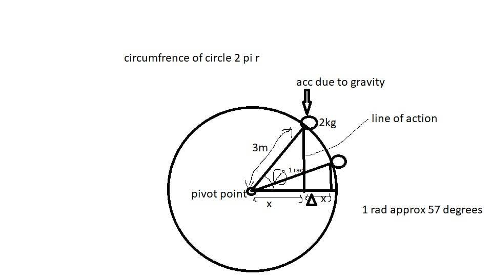

hi my question is that say if rod of length l is 3m and is 90 degrees from horizontal pointing upwards with 2 kg weight on the end then there will be no torque produced because the force of gravity is acting parallel to the lever arm if the angle theta is 80 degrees then the torque would be weight force x l sin theta giving the lever arm x and if the rod was horizontal then the torque would be the weight force x l because the weight force would be acting perpendicular to the lever arm ie its maximum length i think i have to take an integral but I am not sure how i know that the torque increases as x increases but i don't know how to do it I am really stuck i want to find the total net torque as the weight moves around the quarter circle can anybody help it would be much appreciated thanks in advance i can provide a diagram if that would help you to get what I am talking about

Do you have a diagram that you can post? Use the Upload button in the lower right of the Edit window to upload a JPEG or PDF copy of your diagram. Thanks.
Integral with respect to what variable? Please post the complete problem statement.
im trying to explain the best i can i have posted a picture as the length x changes with respect to the weight falling round the arc of the circle the torque will increase because the lever arm is getting longer the further from the top it gets to be honest i don't know the right question to ask i have an idea in my head but I am struggling to explain it
If I read the diagram correctly, the mass is constrained to travel along the circle? But then why is your "line of action" vertical?
The trouble is that "total net torque" is undefined until you specify the variable with respect to which you are summing. Could be time, angle, x displacement, y position, ... and these will all yield different answers.
If you could explain why you want to find the total (or average) we might be able to advise on which variable.

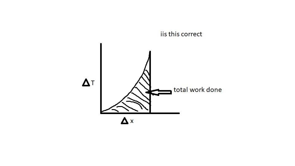

ok got it how do you then find the initial torque and the final torque
Why do you want to find those? How do you plan to use that information?

Ok, but it is really helpful if you state up front everything you are to find. I see you posted a sketch of a graph of torque versus x (whatever x represents there) and ask about initial and final torque. Am I to infer that you are required to sketch such a graph?
Anyway, please put that aside for now and concentrate on finding the gravitational work done.
What are the initial and final angles of the movement?
