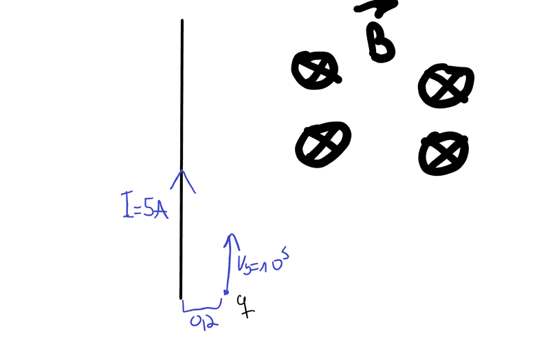

Find the trayectory(x,y) of an electron traveling in a magnetic field created by an an infinite current carrying wire current with intensity 5A. At x=0.2 v=10^5 m/s (y)
Electron charge q=-1.6x10^-19
u0/2π=2*10^-7
The magnetic field varies with the distance of the particle to the wire.

At the start we only have j component of the velocity, but as time passes on we could imagine (at least myself) that Vi starts to exist because of the acceleration created by the force.
This would create another component of force, in this case this force would point downwards.
Fx is created by Vy and Bz
Fy is created by Vx and Bz
F=q(VxB)=qVB V(y) perpendicular to B(z)
B=(u0*I)/(2πR)
If i'm not wong, this are the ecuations of acceleration.
ax=(q*Vy*u0*I)/(2πRm)
ay=(q*Vx*u0*I)/(2πRm)
You don’t specify the orientation of the wire, nor the initial y of the particle.
I could deduce these from your diagram, but that comes from your interpretation. I'd like to see exactly how the problem was stated.
Thanks for replying,
1) The wire rests on the y axis, and the initial y of the particle is 0.
2) The problem reads as follows:
An electron travels parallel to an current carrying wire with initial velocity being 10^5m/s (y) and it's position being x=0.2 (meters) and y=0 at t=0 Determine the trajectory of the electron and(optional) plot it geogebra.

Shouldn't one of your acceleration equations have a minus sign? Check using the constant field version.
haruspex said:
Ok, thanks.
1) Sorry, i don't understand why there would be a minus sign
As my current understanding of the Lorentz Force Fx=q(vyxBz)=qvyBz (because v is perpendicular to B)
Doing this vectorial product gives us a force pointing towards -x, but because we are working with an electron, (-q) points towards +x2) I have tried to simplify the problem to the constant field version but still, I am unable to solve it, it gets complicated really fast and goes beyond my current understanding (even if i have been working on this for about 1-2 weeks)

For the constant field, you know it should go in a circle, so convert to polar and set ##r, \dot\theta## as constants.
Edit: you also know that even in the general case the speed should be constant. I can only deduce that from your equations if I flip the sign of one.

The basic equations are $$\ddot x = \frac{c}{x}\dot y \,\,\,\,\, \,\,\,\,\,\,\,\,\,\, \ddot y = -\frac{c}{x}\dot x$$ where ##c## is a positive constant. The y-axis runs along the current and the origin is chosen such that the initial position of the electron is ##(x_0, y_0) =## (0.2 m, 0).
You can immediately integrate the second equation to obtain $$\dot y = f(x)$$ where you will find that ##f(x)## can be written in terms of ##c##, ##v_0##, and ##\log(x/x_0)##.
Using the constant speed condition ##{\dot x}^2 + {\dot y}^2 = v_0^2##, $$\dot x = \pm \sqrt{v_0^2-f(x)^2}$$ where the minus sign is used for the parts of the trajectory where ##x## is decreasing. In principle, this equation could be integrated to obtain ##t## as a function of ##x## and then inverted to obtain ##x(t)##. But the integration looks to me to be too difficult to do except numerically.
Note that ##\large \frac{dy}{dx} = \frac{\dot y}{\dot x}##. Thus, you can obtain $$ \frac{dy}{dx} = \pm \frac{f(x)}{\sqrt{v_0^2-f(x)^2}} \equiv h(x) $$
Then $$y(x) = \int_{x_0}^x h(\bar x) d{\bar x}$$
