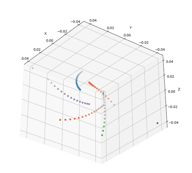

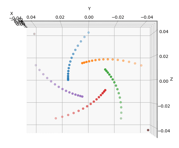

i managed to whip something up.
the procedure is fairly straightforward:
  1. set inlet and outlet diameters. the former can be calculated directly, the latter can be corrected afterwards.
  2. calculate inlet and outlet velocities based on flow and head requirements.
  3. calculate acceleration components in axial, radial and circumferential directions. these are kept constant in rotating frame of reference.
  4. draw trajectory points based on current velocity*timestep.
  5. calculate outlet angle defined by relative and circumferential velocity
  6. correct outlet diameters if the angle is not OK.
here's the python code:

that draws absolute/relative trajectories for outer streamline only and doesn't correct outlet diameter. to me, it looks very similar to the better designs I've come across so far. there's still some work to be done, like inner streamlines, blade thickness corrections, slip corrections, CFD, ...
