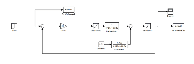

I'm currently creating a PID control system for a Voice coil motor, my issue is obtaining the transfer equation that relates the voltage to the displacement. Ignoring gravity it is easy however once gravity is included I can't figure out how to rearrange it.
In the time domain the equation that I have come up with is
http://mathhelpforum.com/attachments/differential-equations/27771-transfer-equation-voice-coil-motor-equation.png
the derivation from fist principles can be provided if needed
I've applied the laplace transform to the equation to get:
http://mathhelpforum.com/attachments/differential-equations/27772d1364923937-transfer-equation-voice-coil-motor-equation.png
I could really use some help, and I would be very grateful for any advice offered.
Thanks in advance

I'm currently creating a PID control system for a Voice coil motor. The end goal of the project is to create a tactile simulation display that mimics softness. The basic principle it is modeling is if you take a samle of silicone and press on it the material will defom and the top will bow around you finger.
The device will mimic this by measuring the force that a person presses on a load cell with and then the voice coil motor will move the frame causing a strip of polyimide film to wrap around the participants finger simulating softness.
My issue is obtaining the transfer equation that relates the voltage to the displacement. Ignoring gravity it is easy however once gravity is included I can't figure out how to rearrange it.
I have actually developed a PID controller and I'm now writing up my report, as such I know that the effects of gravity cause a steady state error of about 3mm (this is compare to when it was moving horizontally when there was no error)

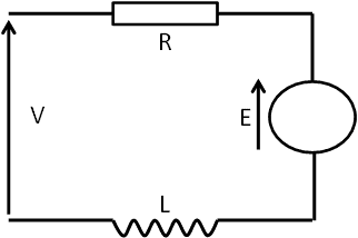

The next step is to define the relationship between the voltage and the current, this is achieved by analysing the equivalent circuit.
From the figure the equation below was derived
[itex]V=IR+E+L\frac{di}{dt}[/itex]
As the inductance for the motors that will be used is negligiable in comparison to the other variable taking this and rearranging with respect to current, I, we get
[itex]I=\frac{(V-E)}{R}[/itex]
As the back emf is proportional to the velocity of the voice coil motor ([itex]E=K_E\ddot{X}[/itex]) equation XX can be derived.
[itex]I=\frac{V-K_E \ddot{X}}{R}[/itex]
where KE is the back emf constant. Substituting equation XX into equation XX gives
[itex]\ddot{X}=\frac{B \frac{V-K_E\dot{X}}{R} L-mg}{m}[/itex]
Rearranging (and using the magnetic field constant [itex]K_b = BL[/itex] gives
[itex]V=\frac{RmX ̈+K_b K_E\dot{X}+mg)}{K_b}[/itex]
As the inductance for the motors that will be used is negligible in comparison to the other variable taking this and rearranging with respect to current, I, we get
E = KE dx/dt, not d2x/dt2.

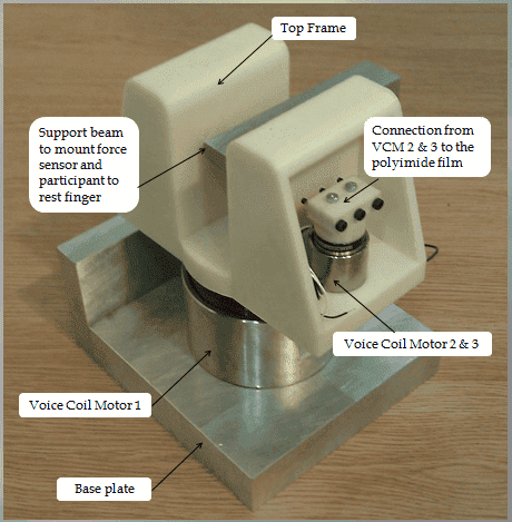

Sorry if I'm missing the obvious, but why are there 3 actuators, and what does a "participant finger" have to do with all of this? What is that mechanism used for?
the two smaller VCMs will vibrate and hopefully simulate wetness. The larger one simulates softness.
:confused:
berkeman said:
:confused:
Lol, if you are interested the work we are doing is based of the research done by some Japanese researchers, their paper explains the priciples about how softness can be displayed, we are creating a similar device and then also testing for wetness which is based on work done by a 3rd year student who determied vibrating surfaces can mimic wetness. The original paper is called "A Softness Feeling Display with an Active Tensioner Controlling Contact Pressure Distribution on a Fingertip" if you want to look it up.

Firstly thanks for spending the time to help me out it is much appreciated!
I think the best thing to do is explain the entire set up of the system
So feedback wise I am using a laser displacement sensor that records the height of the voice coil motor. this is fed into a PID controller (I can give you the values if you need them) these valuse were obtained mainly through trial and error, the error signal going into the PID controller is obtains by subtracting the current distance from the original one.
I originally ignored gravity completely which made the equation very easy and I got
[tex]\frac{X(s)}{V(s)} = \frac{K_b}{RmS^2+K_{b}K_{E}S}[/tex]
simulating this was nice and simple and operating the device on it's side (thus removing gravity) showed that it followed this model. Positive voltage moved it up, negative back down
However when being used the right way up the device behaved differently, the most noticeable difference was the introduction of a steady state error, and small oscillation. Through trial and error I was able to remove both of these issues. However because the tuning I had done in the original simulation was not all that useful I was hoping that I could come up with a new transfer function that included gravity.
I hope that clears the background up a bit.
Regarding the voltage to stop it free-falling I just have a single PID controller outputting a voltage depending on the distance.
Now we're finally getting somewhere.
If you give me your entire system in transfer function or or other form, including the laser position sensor, your PID controller, - everything! - then maybe I can help you sort things out.
I hope you have a system simulator like Matlab or whatever? I haven't used mine in ages so I may ask you to run a few simulations as we go along.
I have both Matlab and Labview, both of which I'm confident using to run simulations.
The issue that I'm having it trying to obtain the transfer function for the overall system, the closest I have for the plant equation is what I showed you in an earlier post, which is in the time domain.
unfortunately that is as far as I can get. I feel that the issue is that I am wanting the equation in terms of displacement, but gravity is a constant acceleration and I've not related it to how it affects the displacement.
