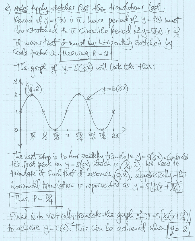

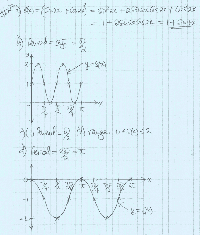

let ##f(x)= (\sin 2x + \cos 2x)^2## and ## g(x)= cos 2x-1## The graph of ##y=g(x)## can be obtained from the graph of ##y=f(x)## under a horizontal stretch of scale factor ##k## followed by a translation of vector ##(p,q)##, find the exact values of ##k, p, q##
horizontal and vertical stretch....
kindly note that this solution is NOT my original working. The problem was solved by my colleague. I have doubts with the ##k## value found. Is it not supposed to be ##k=0.5?## as opposed to ##k=2?##. From my reading on scaling, the graph shrinks when ##k## is greater than ##1## and conversely.
That's certainly true, but check it for yourself: Plot ##sin (x)## vs ## sin (2x)##.
chwala said:
the graph shrinks when k is greater than 1 and conversely.
A better way to say this, regarding f(kx) vs. f(x) is this:
Horizontal compressions/expansions
If k > 1, the graph of y = f(kx) is the compression of the graph of y = f(x) toward the vertical axis.
If 0 < k < 1, the graph of y = f(kx) is the expansion of the graph of y = f(x) away the vertical axis.
Vertical compressions/expansions
If k > 1, the graph of y = k* f(x) is the expansion of the graph of y = f(x) away from the horizontal axis.
If 0 < k < 1, the graph of y = k* f(x) is the compression of the graph of y = f(x) toward the horizontal axis.
For negative values of k, there are reflections happening, which is a different matter.
