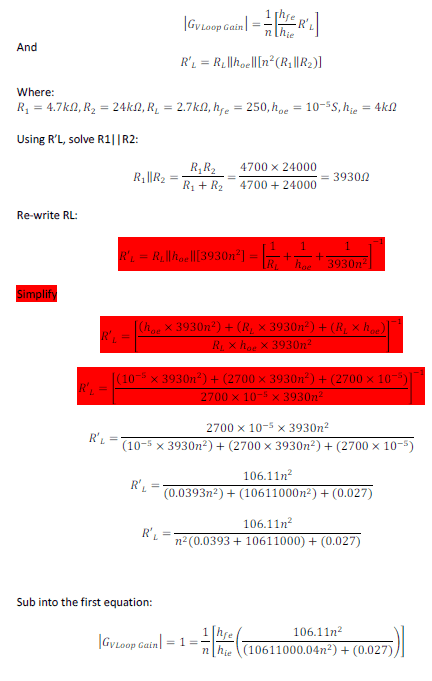

It can be shown that the loop gain of the oscillator at resonance is given by equation 1, Where R'L is given by equation 2.
Estimate the turn ratio
Gvloopgain = 1/n ((hfe/hie)R'L) .......................1
R'L = RL || hoe || (n^2(R1 || R2)) ...................2
When:
R1 = 4700
R2 = 24000
RL = 2700
Hie = 250
Hoe = 10^-5
Hie = 4000
242437
242438

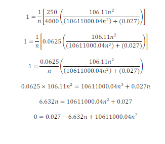

But the quadratic doesn't work. I can't see where i have gone wrong. Is my approach miles off?
Thanks

##h_{oe}## is an admittance (units are Siemens). So I think you'll want to use ##1/h_{oe}## to convert it to a resistance in your ##R'_L## calculation.
