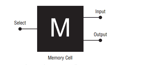

nabil__
Transistors are tiny crystal of silicon. Transistor switch and it's support component are memory cell.
A single memory chip can hold up to 4 transistor ? What is the shrinking bit ?
Can you please explain?
a few more than that ....
eg.
a 64Mb Dynamic RAM chip has over 67 million transistors on it
a 1Gb Dynamic RAM chip has over 1 billion transistors on it

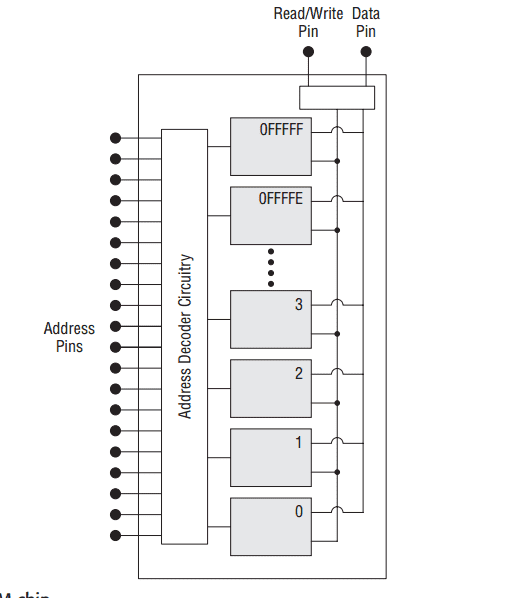

davenn said:
@nabil__
you just quoted me with no words from you ... did you want to ask or say something else ?
Yes. Is the following diagram ( attached ) performs operation with the previous diagram attached ?
How and why ?
This is equivalent to memory cell except the complexity of circuits are hidden.
How to calculate that how many memory cell a memory chip can hold ?

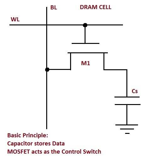

DRAM does not use a 4-transistor cell, they store the information in a capacitor.
