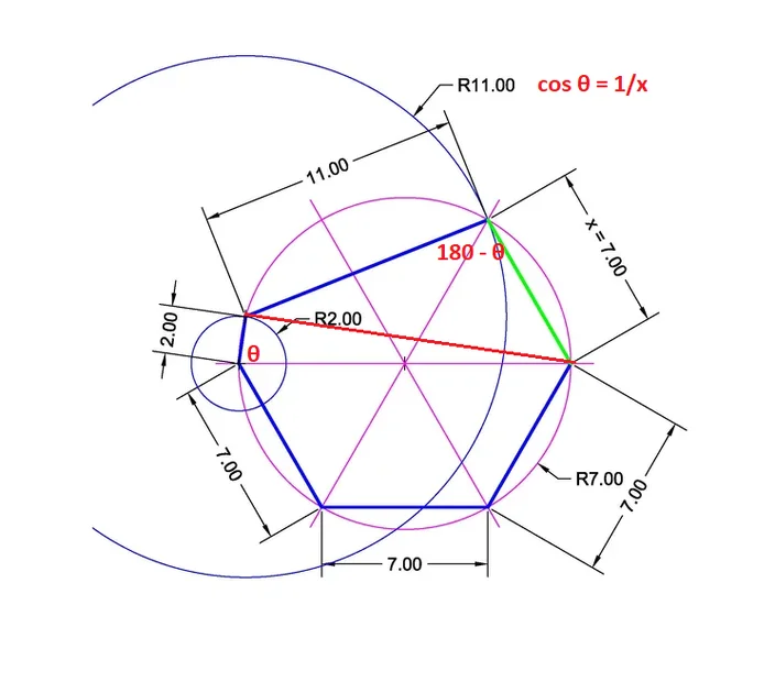

@kuruman You essentially have the same solution for ## x=R ## in post 30 that @renormalize has, but you should recognize that the difference of cubes factors.
This form is even simpler than what the video of post 18 has where you get ## (a+2b)^2=3(4x^2-a^2) ## with ## a ## appearing on both sides of the equation as I have in post 24.
This final simple form that @renormalize has in post 32 looks to be the reason why there are as many integer solutions for this thing as there are. Certainly the clumsy quadratic equation in ## R^2 ## that I used in my very first solutions in this thread looked like it would be about a one in ten thousand chance or less of getting an integer solution for ## x ##. When the answer for the ## a=2 ## and ## b=11 ## combination in the Olympiad problem was exactly 7, it almost looked like some kind of magic.
This solution of ## x=\sqrt{\frac{a^2+ab+b^2}{3}} ## is indeed a rather simple form.
Thank you for everyone who contributed. :)
  • #39
Here is the derivation mentioned in post #30.
Refer to the figure on the right. It shows half the hexagon as a quadrilateral inscribed in a circle of radius ##R##. The full hexagon can be obtained by reflecting the quadrilateral about the diameter or by appending to it itself rotated by ##180^{\circ}##.
I have labeled the angles subtended by the chords, by Greek letters related to their label in Latin, e.g. angle ##\alpha## for chord ##a## etc. I state without proof the following.
1. The angle subtended by a chord is invariant if the point that subtends it on the circumference is moved along the circumference. For example, ##\alpha = \angle DCA=\angle DBA.##
2. The angle subtended by a chord at the circumference is half the angle subtended by the same chord at the center of the circle. For example, the angle subtended by a diameter is ##180^{\circ}## at the center and ##90^{\circ}## at any point on the circumference.
3. The length of a chord is given by the the diameter times the sine of the subtended angle. For example,##~DA=a=2R\sin{\alpha}.##
Now for the derivation. We write the diagonal ##DB## in two ways using the law of cosines for triangle ##(DAB)## and the Pythagorean theorem for right triangle ##(DBC).## Note that the angle between vectors ##\mathbf a## and ##\mathbf x## is ##\theta = 180^{\circ}-(90^{\circ}+\beta)=(90^{\circ}-\beta)##. Therefore, ##\mathbf a\cdot\mathbf x=ax\sin\beta.## Thus, $$d^2=a^2+x^2+2ax\sin\beta=4R^2-b^2.$$ We now set ##x=R##, ##\sin\beta=\dfrac{b}{2R}~## and rearrange to get, $$ a^2+ab+b^2=3R^2.$$ Using the identity ##a^3-b^3=(a-b)(a^2+ab+b^3)## and rearranging, yields $$R^2=\frac{a^3-b^3}{3(a-b)}.$$While thinking about this, I stumbled upon something that might be of interest. I will post it on a separate thread on this forum as a solved problem.
One more approach based on
https://en.wikipedia.org/wiki/Cyclic_quadrilateral and the cosine theorem.
## \angle FGB=120^\circ\implies\angle FEB=60^\circ ## (Supplementary angles)
## \cos(\angle FEB)=(c^2-7^2-7^2+11^2)/(2\cdot(11\cdot c+7\cdot7))\implies c=13 ## (Angle formulas)
## \cos(\angle EFG)=(c^2-11^2-7^2+7^2)/(2\cdot(7\cdot c+11\cdot7))=1/7 ## (Angle formulas)
## d^2=c^2+7^2-2\cdot c\cdot7\cdot\cos(\angle EFG)\implies d=8\sqrt{3} ## (The cosine theorem)
In the same way it can be calculated that:
## \angle ADG=60^\circ ##
## b=13 ##
## \cos(\angle DGF)=11/14 ##
## a=5\sqrt{3} ##.
## c\cdot b=7\cdot x+a\cdot d\implies x=7 ## (Ptolemy's theorem)
