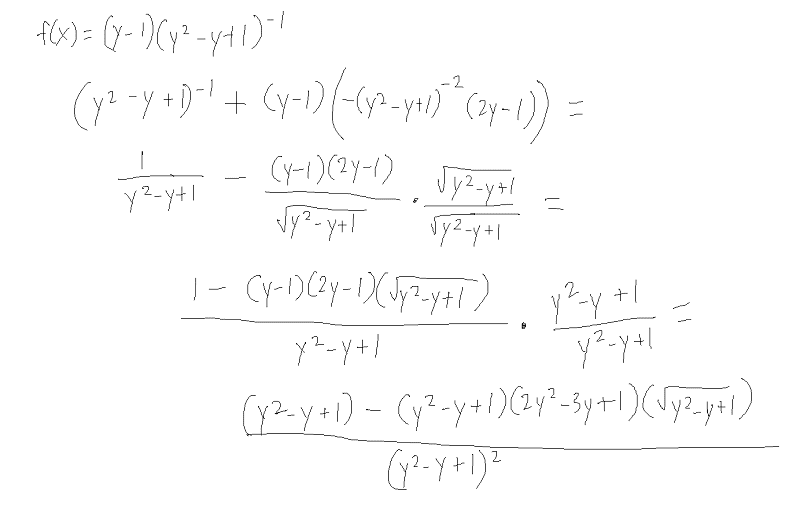

Derivative of \frac{y - 1}{y^2 - y + 1}
The solution is \frac{y^2 - 2y}{(y^2 - y + 1)^2} but in my work, the answer will have something to the 4th power on the top which will be impossible to cancel out. What have I done wrong?
Edit: Never mind, I see my mistake
Remember: \frac{d}{dx}\frac{f(x)}{g(x)} = \frac{g(x)f'(x) - f(x)g'(x)}{g(x)^2}
Yes but I don't like to work with the quotient rule. I should be getting the same answer using the product rule anyway, right?
That's fine.
Then, remember: -(y^2-y+1)^{-2} = -\frac{1}{(y^2-y+1)^2}
(An expression to the -2 power doesn't equal 1/sqrt(expression))
