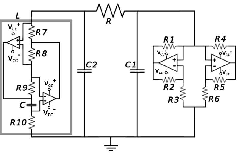

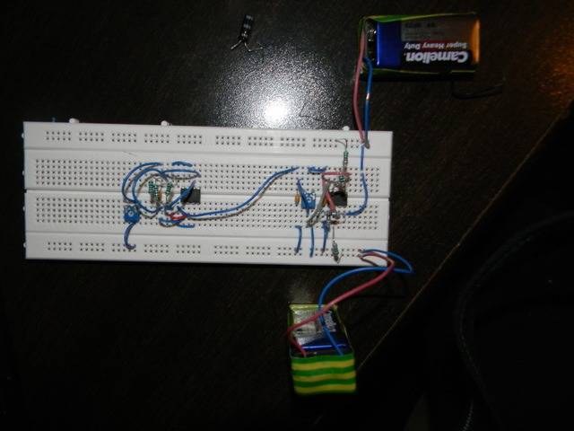

So I built this circuit(Chua's chaotic circuit) and I have to take it to the lab for plugging it to oscilloscope.I need to make sure it works, cause I won't have any time there to fix it or rebuild it.So when I i tested it with the multimeter,there was no voltage on the left side and there was a voltage of a constant value on capacitors(I checked the connections and everything is okay).So is this because of the frequency? Or am I doing something wrong?(Note:left side has to behave like an inductor)
Could you supply a circuit diagram?
Check all wiring. The power supply pins on the ICs should have the right voltages on them. These stay constant so they are a good starting point.

This is the schematic:

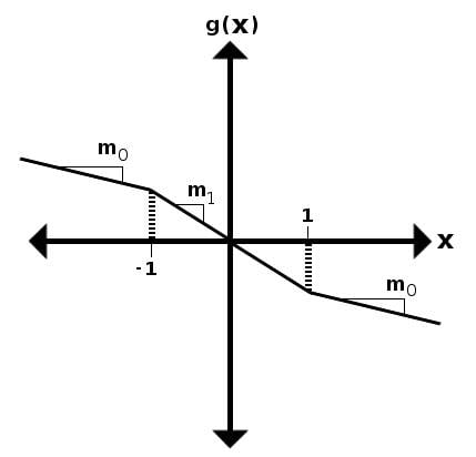

This is the function of a chua's diode, g(x)is resistance vs current:

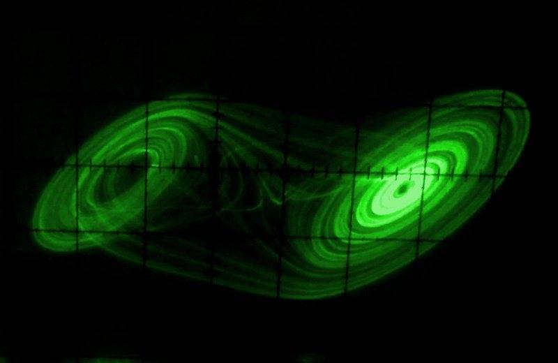

This is the double scroll
Yes, but shouldn't it oscillate?I highly doubt its a connection problem.
You can't tell if something is oscillating when you use a multimeter. You might get a reading on AC volts but these ranges are often pretty insensitive.
So, you may have to wait until you get an Oscilloscope connected to it.

In the meantime, I would really check those voltages and connections. I don't trust breadboards, so the time to find any problems is before you leave home.

Thanks for the advice, I'll post an update on how it worked out.The reason I chose the breadboard
over a PCB, was that I'm planning on experimenting(different combinations and values of resistance and capacity)
