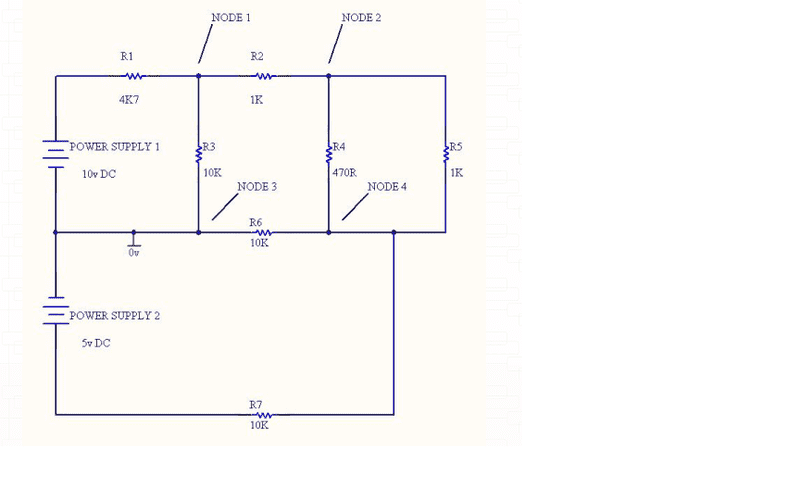

Hey, I'm having trouble with a 2 PSU resistor NA circuit. here is what I've done:
N1=V1
N2=v2
N3=v3 = 0V
N4=v4
0=(10-v1)/4K7-V2/10k-(V1-V2)/1K
0=(V1-V2)/1K-(V2-V4)/470-(V2-V4)/1K
0=(V4-5)/10K-V4/10K
there's at least something wrong with eq 3 because it can't be solved?
Thanks for any help

Perhaps you can simplify the circuit first? I think that R4 and R5 are in parallel and the resulting R45 in series with R2.
Shouldn't it be easy enough without simplifying + I lose node 4 if I do that.
Do a KCL at Nodes 1-4.
Hah...just read it and saw you did already I think.
But as an example at Node 1...
(Vx1-10)/R1 + (Vx1-Vx3)/10K + (Vx1-Vx2)/1K = 0
I think in your KCLs you worked backwards compared to me so not sure if this will help or confuse you.
thats the same as mine I think, V3=0V
node 4 is what I have wrong I think.
Thanks
Node 4:
(Vx4-5)/10K + (Vx4-Vx3)/10K + (Vx4-Vx2)/470R + (Vx4-Vx2)/1K = 0
Should be right for that node.
