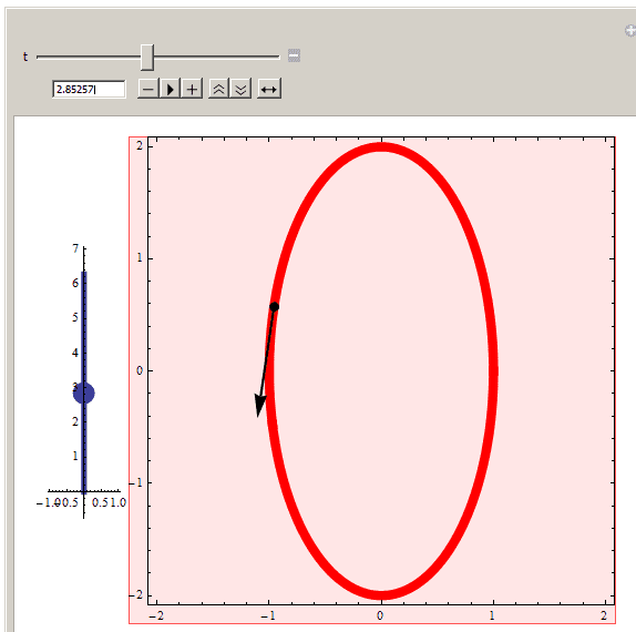

OK, this looks like a differential geometry problem, which it is, but at the end of the day I am trying to figure out why the unit normal and unit tangent vectors to a curve aren't orthogonal, so even if you don't know about DG, please respond.
Truly Bizarre - The unit tangent and unit normal vectors aren't orthogonal
Obviously the two choices for E_1 and E_2 are the unit normal and unit tangent vectors to the curve.
Using Mathematica...
alpha[t_] := {Cos[t], 2 Sin[t]};
alphaprime[t_] := {-Sin[t], 2 Cos[t]};
alphaprimeprime[t_] := {-Cos[t], -2 Sin[t]};
unittangentvector[t_] := alphaprime[t] / Norm[alphaprime[t]];
unitnormalvector[t_] := alphaprimeprime[t] / Norm[alphaprimeprime[t]];

However, graphically, the unit tangent and unit normal vectors are far from perpendicular on this curve!

The unit normal isn't alphaprimeprime[t] / Norm[alphaprimeprime[t]]. It's the derivative of the UNIT tangent vector divided by the norm of the derivative of the UNIT tangent vector. alphaprime isn't UNIT.

Thanks, and that would seem to do the trick, but mathematica is hating me right now. Any ideas what's going on? Here is the newly defined unit normal vector
unittangentvector'[t] / Norm[unittangentvector'[t] ];
E1[t_] = unitnormalvector[t];
E2[t_] = unittangentvector[t];
Mathematica animation of a red elliptical curve centered at the origin, spanning x from -2 to 2 and y from -2 to 2, with a black arrow tangent to the curve at a point on its left side and a black dot marking that point; a slider labeled t reads 2.852571, and a small inset plot shows a blue point on a vertical axis from 0 to 7.

Well, at least theoretically, would you agree that my choice of E1 and E2 provide a frame field on the curve?
Sure. The unit tangent T points along your curve. T' must be perpendicular to that. Just differentiate T.T=1. It's got to work, right?
