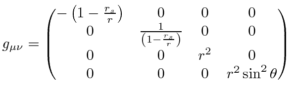

I am trying to create a function to calculate the Christoffel Symbols of a given metric (in this case the Shwartzchild metric). Calculating the (non zero) Christoffel Symboles for the Shwartzchild connection, I am a double major in Physics and Computer Science so I decided to go the code rout. It looked pretty trivial but I appear to be getting the wrong answers and I am trying to figure out why. I am wondering if maybe you can't address the indices in the way I am, but I don't know how you would otherwise, or maybe I am taking the tensor product incorrectly?
If anyone could review what I have done and give me some pointers that would be great! I have it running in a Jupyter Notebook but I will just post the code here as a python file. The debug option will output the entire Christoffel tensor as XML so you can copy/paste it into a text editor like notepad++ and fold the different parts up.
I am uploading the python code as a .txt just rename to .py (or copy/paste into one) when downloaded please :) numpy, scipy, and sympy packages are required
NOTE 0: I am not asking for help with debugging, I am trying to figure out mathematically what I am doing wrong in the code.
NOTE 1: Actual calculation at line 77
Thank you for reading!

Thank you for the reply.
"g" or in the code "metric" is a 4x4 matrix with the things in front of the 'd' whatevers in this equation
(source: my homework)
along the diangnal too look like this
(source: https://hepweb.ucsd.edu/ph110b/110b_notes/img1109.png)
Then the actual expression I am trying to calculate is this
a 4x4x4 "3d matrix"

I looked there, I tried modifying my code by changing:
Code:
results[ l ][ m ][ n ] += ( 0.5 * metric[ l ][ p ] *
                                               ( Derive( metric, m, p, symboles[ n ] ) +
                                               Derive( metric, n, p, symboles[ m ] ) -
                                               Derive( metric, m, n, symboles[ p ] ) ) )
to
Code:
results[ l ][ m ][ n ] += ( ( Derive( metric, m, p, symboles[ n ] ) +
and adding in
Code:
            for i in range( 4 ):
                results[ i ] = ( 0.5 * Matrix( metric ) * Matrix( results[ i ] ) ).tolist()
after everything was summed and calculated, basically calculating the matricies (adding/subtracting) then multiplying them by the plain metric using the Matrix class to avoid error, this should work in this case, ran a quick test too see if:
A*B + A*C = A( B + C )
and it seemed too. However what I got out was a bunch of garbdly gook, so it makes me question either that premise or my calculations.
I question the ladder, it would seem that
Code:
metric[ l ][ p ]
in
Code:
metric[ l ][ p ] * ( Derive( metric, m, p, symboles[ n ] ) + Derive( metric, n, p, symboles[ m ] ) - Derive( metric, m, n, symboles[ p ] ) ) )
only goes up and down one row for each matrix in the resulting tensor, I don't know if that is something that is suppose to happen or not? The results seem more correct than a straight up multiplication. I just don't know if this is a valid way to multiply a matrix/take a tensor product(?)
