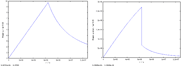

Is it right?
Well, according to Wikipedia, yes (note it uses the opposite sign convention and the compact form of the metric). So it must be right [citation needed]. Wikipedia does cite Schwarzschild’s original paper, but the form Schwarzschild used is sufficiently different (algebraically) to be difficult to compare, and my German isn’t up to following it. But other sources do agree with Wikipedia (e.g. http://insa.nic.in/writereaddata/UpLoadedFiles/IJPAM/20005a6c_9.pdf, and Schutz’s textbook).
We can also do a sanity check by calculating the proper acceleration of a hovering observer at different radii, plugging in numbers for the Earth, and comparing it to the Newtonian case. We don’t expect an exact match (not least because Schwarzschild’s ##r## and Newton’s aren’t quite the same things), but for a weak field like the Earth’s, this shouldn’t make much difference.
The choice of Schwarzschild-like coordinates pays off again because a hovering observer is not changing spatial coordinates, so has four-velocity ##U^\mu=\left(c/\sqrt{-g_{00}},0,0,0\right)##. The four-acceleration is given by ##A^\mu=U^\nu\nabla_\nu U^\mu##, and the proper acceleration is just ##a=\sqrt{g_{ij}A^iA^j}##. To carry out this calculation in Maxima I wrote a function to do the covariant differentiation and the acceleration and ended up writing another to substitute in the numbers. This is a bit complex, but the plotting is as easy as you might expect. The expression for acceleration is ugly enough and long enough that I won’t bother putting it here. The code, the resulting graph, and the fractional difference from the Newtonian case are below.

/* Plot */
plot2d(putInNumbers(ps),[r,0,6.4e6]);
plot2d(proper_acceleration,[r,1,12.8e6],[xlabel,"r / m"],
[ylabel,"Proper g / ms^{-2}"]);
plot2d(proper_acceleration_diff,[r,1,12.8e6],[xlabel,"r / m"],
[ylabel,"Proper g error / ms^{-2}"]);
Field of Frames graph
Note the scale (##3\times 10^{-8}ms^{-2}##) on the difference (right-hand) graph. So this all looks good.
