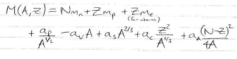

Thanks for the reply. To be honest (I should have put this in the original post) I'm trying to get more of a descriptive difference i.e.
Can a fermi liquid be described (as in nuclear terms) as a drop of liquid being pulled by its surface tension into a spherical shape, thus as in a drop of liquid interactions occur but only with neighbours.
And for the fermi gas, can the electrons (as in nuclear terms) be described as being able to move freely in a spherically symmetric potential well.
I see what you are saying but we have been given for the fermi liquid model:
And for the fermi gas model, a calculation of fermi momentum and fermi energies.
I wouldn't be sure how to relate the former to solid state.
I have a feeling we are using the same name but with different meanings.
