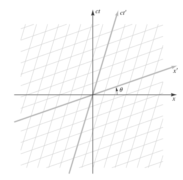

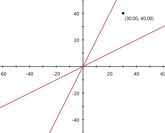

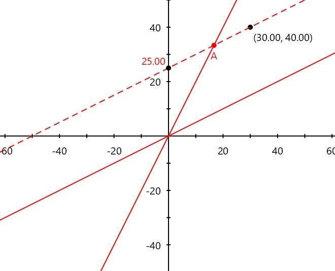

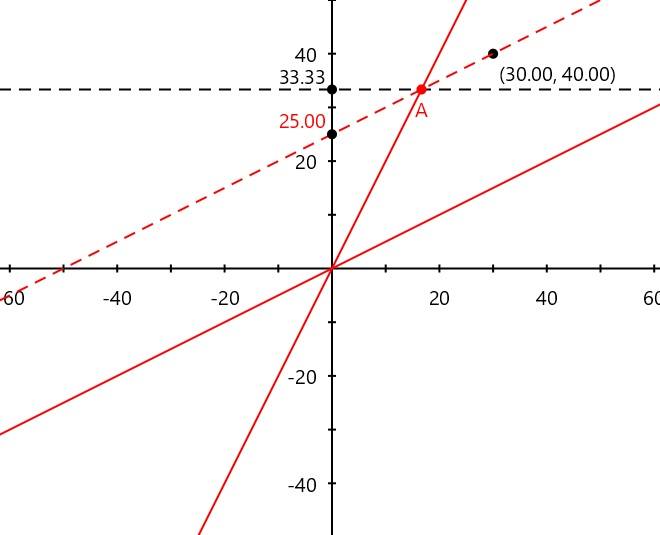

Trying to understand space-time diagrams
  • Context: Undergrad
  • Thread starter Thread starter Kashmir
    Diagrams Space-time
The discussion revolves around understanding space-time diagrams, particularly in the context of special relativity and Minkowski geometry. Participants explore the mathematical transformations between different inertial frames, the implications of these transformations on the geometry of space-time, and the interpretation of angles and distances within this framework.
  • One participant questions the correctness of calculating the time coordinate in a new frame as ##c t^{\prime}=\sqrt{a^2+b^2}##, suggesting it should be ##\sqrt{a^2-b^2}## instead.
  • Another participant explains that Minkowski space geometry differs from Euclidean geometry, emphasizing that the Minkowski version of the Pythagorean theorem is ##s^2 = (ct)^2 - x^2##.
  • There is a discussion about the terminology of scalar products, with some participants noting that while Minkowski geometry does not adhere to positive definiteness, it can still be referred to as a scalar product.
  • Participants express caution regarding the application of Euclidean geometry to Minkowski diagrams, stressing the need for clarity in understanding the underlying geometry before drawing diagrams.
  • One participant raises a question about the angle between the ##x## and ##x'## axes, leading to a discussion about the nature of hyperbolic angles versus Euclidean angles.
  • Another participant points out that the angle ##\theta## is treated incorrectly when using the inverse tangent function, suggesting that hyperbolic functions should be used instead.
Participants express differing views on the correct interpretation of distances and angles in Minkowski space, with no consensus reached on the proper application of Euclidean versus hyperbolic geometry in this context.
There are unresolved questions regarding the definitions and applications of scalar products in different geometrical contexts, as well as the implications of using Euclidean versus hyperbolic angles in calculations related to space-time diagrams.

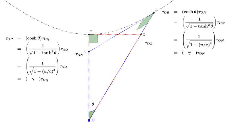

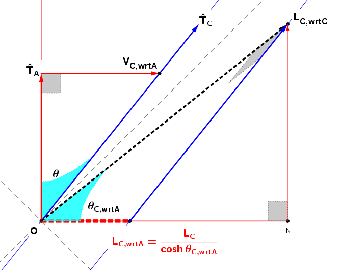

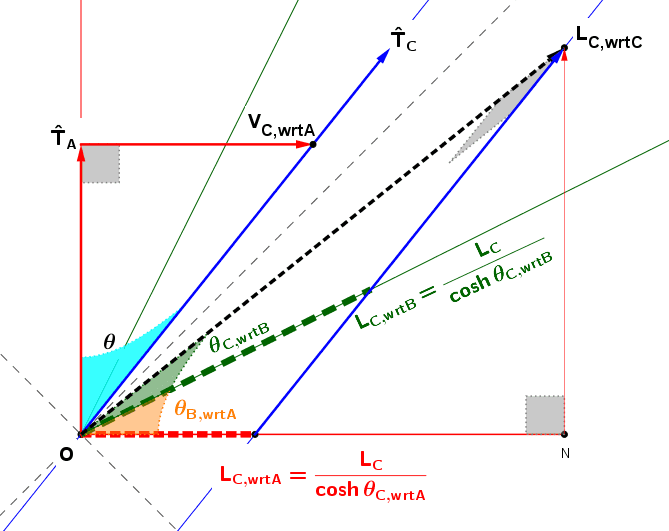

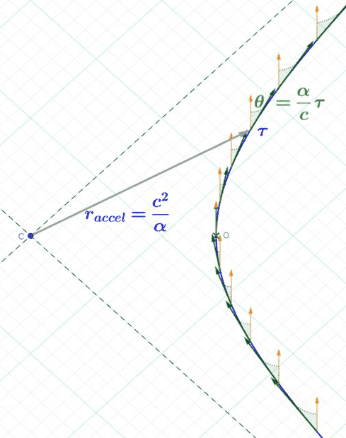

  • #32
These diagrams may help you appreciate that "rapidity" can be thought of as an "angle",
when used properly. As with any tool, one must learn how to use it and how not-touse it.
Note the use of an arc of the "Minkowski circle"...
so we don't fall into the trap of thinking in terms of Euclidean geometry, as @vanhees71 warns us about.
From https://www.physicsforums.com/threads/velocity-through-spacetime.957038/post-6068213
From my answer to https://physics.stackexchange.com/questions/494698/a-best-definition-of-proper-acceleration
From
https://physics.stackexchange.com/questions/667907/lorentz-transform-moving-length-to-moving-length
In my opinion, since we teach students to use trigonometry to solve free-body diagrams,
we can leverage that experience in trying to teach relativity via hyperbolic-trigonometry
(on the way to possibly having them work with vectors and tensors and use invariant thinking).
There has to be something to show the "geometry" encoded by the tensor-algebra.

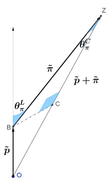

As an example of the power of trigonometry, look at my answer to this question:
https://physics.stackexchange.com/q...-out-of-knowledge-kinetic-energy-in-lab-frame
The question asks for a derivation of
##|\vec{p}^{\text{com}}_{\pi}|=\frac{M_{p}\sqrt{T^{L}_{\pi}(T^{L}_{\pi}+2M_{\pi})}}{\sqrt{(M_{p}+M_{\pi})^{2}+2T^{L}_{\pi} M_{p}}}##
and wonders about whether it is dependent on the frame of reference.
My answer gives an answer by interpreting the formula given
as the altitude of a triangle CB in connection with the Law of Sines in Minkowski spacetime.

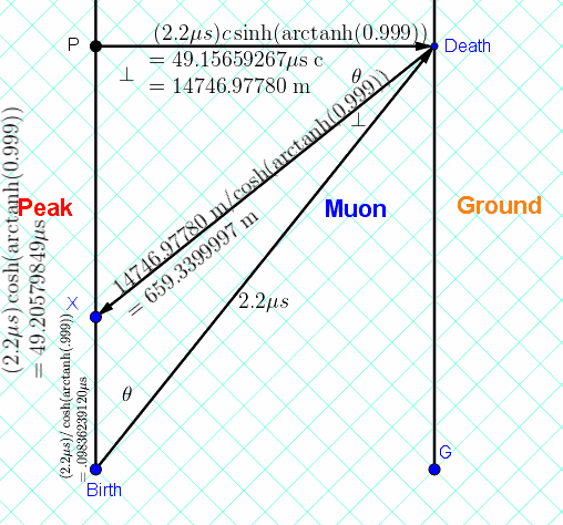

Here is the muon problem solved trigonometrically (however, no angular arcs shown)
from https://physics.stackexchange.com/q...-distance-traveled-and-the-times-it-takes-why
To play around with the analogy,
try https://www.desmos.com/calculator/emqe6uyzha
Set ##E= -1##, then play around.
Move the slider slowly back to ##E= +1##.
See https://www.physicsforums.com/threads/why-is-time-orthogonal-to-space.969731/post-6159973 for a description of an earlier version of this.

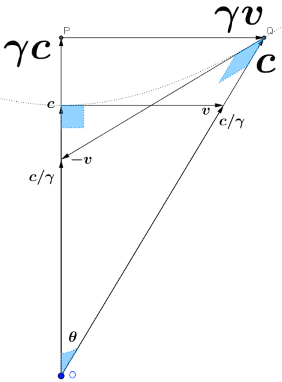

  • #33
Kashmir said:
So you defined rapidity ##\theta## as area that lies inside two lines that touch the unit hyperbola . If rapidity is ##\theta## then one of the intersection point of hyperbola with the line is ##(cosh(\theta), sinh(\theta)##.
Now getting back to our figure :
The ##\theta## here is rapidity?
Along the lines of what I replied to your comment in
https://physics.stackexchange.com/questions/728994/angle-in-a-spacetime-diagram/729066#729066
All of the events on the ##x'##-axis are on the line with slope ##ct=x \tanh\theta##.
Personally, I would reserve "rapidity" to refer to the angular-like measure between timelike lines. The indicated quantity between these spacelike-lines which are coplanar with the 4-velocities are numerically equal to the rapidity in Minkowski spacetime (but not in a Galilean spacetime).
Further, given two arbitrary spacelike lines in (3+1)-Minkowski spacetime,
a similarly-indicated measure of separation between those lines
need not be equal to the rapidity between the ##t##- and ##t'##-axes...
since those lines are not necessarily coplanar with the plane spanned by the time axes.

  • #38
From
View attachment 314569View attachment 314570
View attachment 314571Here is the muon problem solved trigonometrically (however, no angular arcs shown)
And this is supposed to be simpler than teaching (multi-)linear algebra with the Minkowski product as fundamental form of a Minkowski space? For me the deliberation from drawing Minkowski diagrams in high school to tensor algebra and calculus was a revelation.

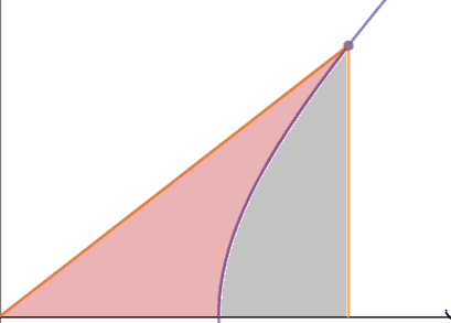

  • #39
Just a comment regarding angle as the arc length of the unit circle vs area in the case of the Minkowski geometry:
It is of course possible to reformulate the Euclidean case in terms of the area of the circle sector as well rather than the arc length of the circle segment (the two being related by a factor of two). This makes the approaches even more analogous.

  • #53
Kashmir said:
I've just begun learning about space time diagrams.
I'm going all the way back to the original OP. The question was about whether a particular formula generated the value of the ##ct'## coordinate. That question has been answered in spades by all the experts.
There is another approach I came up with to calculate the value of the ##ct'## coordinate, one that doesn't require much math. The experts here may be familiar with it, but I've never seen it anywhere. It relies on Einstein's first postulate: The laws of physics have the same form in all inertial reference frames.
Here is the basic problem. We have an event whose rest coordinates are known; this implies we know the units of the ##x## and ##ct## axes. We want to know the event's ##ct'## value.
I've drawn the ##x'## and ##ct'## axes in red, but not added labeled tick marks. We don't even know the relative velocity of the moving observer (although it could be calculated from the angle of the axes).
The first step is to draw a line parallel to the ##x'## axis through the event. All points on this line have the same ##ct'## value (the same time value as calculated by the moving observer). We don't know this value, but we do know the value where the line crosses the ##ct## axis.
We want to know the length from the origin to A (as has been pointed out, this is not a Euclidean length). Draw another line parallel to the ##x## axis. Again, we know where this line crosses the ##ct## axis. All points on this line have this same time value as calculated by the rest observer.
Using Einstein's first postulate, we know that the ratio 33.33:A must be the same as the ratio of A:25. Each represents how each observer views the other's clock rate. Therefore, we just need to solve for A in the equation ##33.33/A = A/25##. The answer is ##A = \sqrt{33.33/25} = 28.87## (approximately).
At one point, I wanted to see if I could explain how to generate a basic Minkowski spacetime diagram (essentially, starting with a rest observer and an observer moving at some given relative velocity, draw the axes, their tick marks, and the worldlines of the two observers) starting from Einstein's S.R. postulates, and without requiring any math. Labeling the units for the axes of the moving observer eluded me for some time; the method shown here fails to avoid all math--I still need a division and a square root--but it's as simple as I could get.
